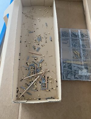

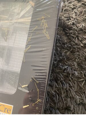

When my kit arrived the parts box had broken open and plenty tiny parts were strewn all over- I’m sure I did not achieve a 100% recovery- time will tell :D
C50CEF5D-539B-4181-A520-AB9484647EA3.jpeg40386109-F55B-46A4-B3FC-B03CCBDC5284.jpeg9C0FAFAA-C310-4EA3-8708-A369DE79CE93.jpeg

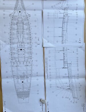

Occre got the instructions so good. Clear, concise and there is no confusion. Wow so different from my Mantua Victory ones.

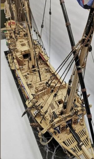

Hi Grant, there she is. I see some small differences compared to my kit, some for the good and others not so much. The thing I like from your kit is that the plate with the keel and stem is solid wood and not stained plywood. So this is een very nice upgrade OcCre did. On the other hand, the cannons are of less quality especially the swivel guns. They look much less refined.
The box has a lot of metal parts, from pumps, colums, oar attachments and more. To me this is "kak" as well. (Being Dutch I understand this perfectly) :p
You can replace the parts if you reconstruct them out of solid wood. Looks much better.
So in the end I want to wish you lot's of fun building this very nice kit and I'm following to see what your plans with her will be.

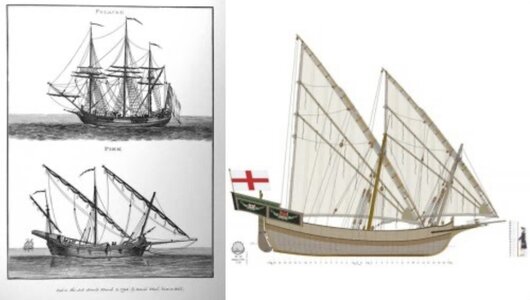

A quick Historical summary from some of the articles I have read :
The name is derived from the Arabic sabaca. This racy sleek vessel is often associated with Mediterranean Barbary Pirates who caused a bit of havoc along the Southern coast of Europe raiding merchant ships at the beginning of the renaissance.
The close association with the Barbary Pirates to the Xebec leads Maritime Historians to believe that they may have been the first to developed this type of ship.
The design appears to be a derivative of the Galley, Caravel and the Pink. The Pink was a sailing boat in the Mediterranean at the time. Caravel in right picture and Pink lower left. 8F9B2E6D-CB31-4728-8C50-16EFE7E8079E.jpeg
In the late 17th Century the “Western “nations around the Mediterranean, who were tired of these fast little ships causing chaos, adopted the Xebec design and built their own. Not only did the “Western” Mediterranean nations use this ship but the design extended further East and North.

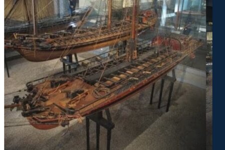

For example in the battle of Svensksund in 1790, in the gulf of Finland, the Swedish gunboats Pojama, Turuma and Udema were of similar structure to that of a Xebec. Catherine of Russia,Inspired by Peter the Great, also called on Spanish shipwrights to build Xebecs. These new designed Xebecs were more maneuverable than the Heavy Swedish gunboats. Clearly this did not help Catherine as The Swedes caught the Russians napping and gave them a good hiding. A famous naval victory was achieved.
The Stockholm Museum models of the Pojama (1776) and the Turuma (1771) show the resemblance:

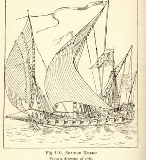

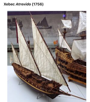

There is common thought that the Occre Jabeque Cazador does not reflect the design of the Spanish Xebec during this period. The Spanish Xebecs built at Cartagena were more like the Tipo Jorge Juan, beautifully built by Ramon Olivenza , and the Atrevido (1756) model at the Naval Museum in Cartagena :
1. Tipo Jorge Juan
2. Atrevido
Cheers Grant

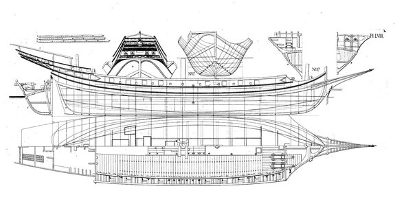

Hi Grant. I have had this plan for quite a while of the Xebec Boberach which was captured from Algiers. Maybe you can use some of the ideas with regards to gun layout and decorations.
AH yes. I have looked at the Boberach design and it is an interesting one. The deck pattern follows the Arabian way, which is unusual for European Xebecs and the gun configuration with 4 full cannons facing forward. I like the hull lines on her. Thanks for this.
