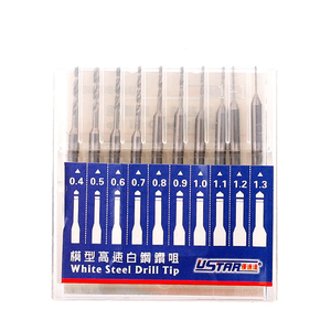

PCB type drills with 1/8'' shank are only good to use on a drill press. For hand drilling with small drill bits I use HSS bit as these ones:
Thanks Y.T.. I was not clear in my original post. I am using the PCB bits in the drill press. Thanks also for the link. ✌️

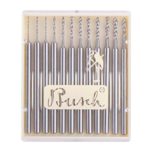

I have these Busch bits, which I keep for drilling brass etc and use cheaper ones for wood.
