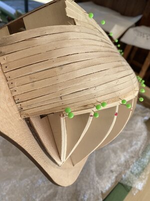

On to planking. I did not want to use the planking plan as suggested in the instructions. Doing this was way more difficult than expected. The lime while brittle was easy to bend with soaking and using a heat gun on a planking board I had made to get the correct bend. The stern was more difficult and some planks split.IMG_0279.JPG
My first dropper planks. I lined off the hull and made a lining table, however I battled to get the exact measurements when tapering the planks. This meant that I could not match my lining table and had to make continuous adjustments. I also found that using 8 planks without tapering at the beginning meant that I could not get the tapering at half the plank width later. As these pictures show I had to insert droppers where they should not have been. For my second layer I read a really good instruction manual on planking. (planking Colour PDF).

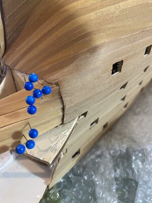

Here are split planks at Stern. I also again misread instructions and did not extend the stern planks to the end of the stern cabin support. Some fixing was required.

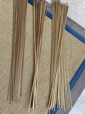

The second layer: I sorted the Walnut strips according to colour as they had different shades. As the lower hull is not coppered I choose the variable shades as I enjoyed the lined or different shade effect....strange I know. Just me. I used a technique of using a drop of CA glue for nails and wood glue on each plank. I did not want nail holes in the planking.
Here the brittle and dry walnut became a challenge. As you can see from the first plank the edges are not smooth. I had to sand each plank, first with 200 grit then 800. This did not resolve the issue completely as tags developed. I could not toss too many planks as they where limited. Any suggestions on how to avoid this for my future ships?
