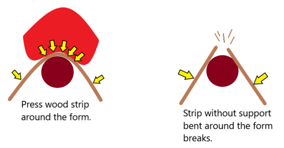

The problem here is cheap, coarse grained wood. It looks like mahogany, which does NOT react well to sharp bending. Also, you should look at the method of bending. Say you need to make a risky, sharp bend with a brittle wood like mahogany or walnut. Just bending the water soaked piece over the fulcrum of your form typically ends up with a disappointing snapping sound, followed by several cuss words. Instead, you need to support the wood close to the bend and curl it over the fulcrum slowly, pressing the wood into shape around the form, and not simply bending it. Using my thumb with hard pressure usually does the trick. Maintain pressure all around the bent portion of the strip. See the diagram below. The yellow arrows show force or pressure. (And yeah, after doing this for hours using a dowel as a form, my thumb gets red). If this does not work, change your wood to a finer grained piece with straight grain. You may choose to use lime wood, poplar or beech, which are flexible woods, and stain them to match the rest of the railings as best you can.
I would wonder what type of wood do you use, from the above images, I can assume it is Walnut (my best guess) or?? I can see, you tried bending from the end. Try bending from the middle! Maybe you didn't soak it well, perhaps this type of wood is brittle? What thickness is your plank, Vic? 2mm?
It is 2 mm sapelle—a relative of mahogany. Brittle. Soaked it well in hot water.
Check Kurt's post. He elaborated this method more in detail. Here is the knowledge of English language comes really handy :cool: However if this is mahogany, you may not succeed in your best tries as the wood is really brittle. Not all wood can be bent, some to a certain degree, others at all. Don't worry, you doing it right. It is just the timber issue...
