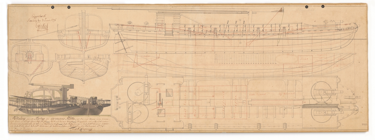

In August 2022, I finished a swedish gunboat, based on some Amati plans as well as photos of model, which served as a guide and also with the support of several comments from a modeling forum ; Anyway, the model ended up in Stockholm, in the room of one of my 8 yo. grandchildren (I wait on a shelf and not “sailing” in the nearby lagoon. In a couple of months they will come to visit and to give a similar gunboat to my other grandson, I started searching on the internet; on the digitaltmuseum.se website, I found several plans of frigates, longboats and gunboats, some plans were just sketches, are not completed, but I found a nice plan of a gunboat named Brynhilda, classified like Påjama and designed by Chapman.

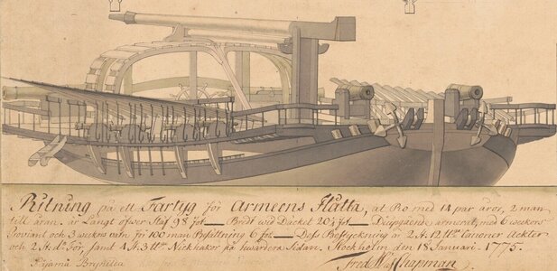

Drawing of a ship for the Army Fleet, to be rowed with 14 pairs of oars, 2 men per oar. Length above the stern: 98 feet - Deck width 20 1/4 feet - Armed draft 6 feet , with provisions for 6 weeks and water for 3 weeks for a crew of 100 men - The equipment is two 12-pounder guns in the stern and two more 12-pounders in the bow, as well as four 3-pounder Nickhooks on each side. , January 18, 1775. Fred H de Chapman. "Påjama Brynhilda"
From the plan, we can see the platforms at the bow and stern for the 12-pound cannons, which are mounted on gun carriages that can move and rotate around a vertical axis; also a central deck where the holds, seats for the rowers and the 3-pound stoners or as they call them Nickhooks are located.

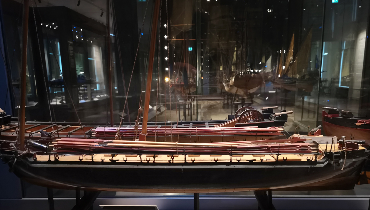

“The Påjama ships were two-masted and single-decker and began construction in 1760. The Påjama ships was the smallest type and can almost be described as a corvette. This made it easier to maneuver than, for example, the Hemmeman, and although she was less well armed, she had the advantage that the artillery could also be used for rowing. The Påjama was primarily intended as a so-called news ship and was mainly used for courier and reconnaissance missions. The four Påjama ships participated only to a limited extent in Gustav III's Russian War. The Brynhilda, built in 1776, took part in the first battle of Svenskund in 1789. She was scrapped in 1799. A contemporary 1:16 scale model of the ship is in the collections of the Museum of Maritime History.
The next photos correspond to the model of the BRYNHILDA (1776) in the exhibition of the Maritime History Museum in Stockholm. There it is at a 1:16 scale, probably made in 1776 by Chapman, it was forgotten until the 1890s where it was restored and exhibited in the Pavilion of the „Archipelago Fleet“, at the General Exhibition of Art and Industry in Stockholm in 1897.

I will work with the OR-2599_1 plan obtained from the digital archive of the Sjohistoriska Museet in Stockholm. I transcribed it into AutoCAD and took its dimensions, trying various scales, it seems to me that a scale of 1:75 is suitable for the available space, the model would be about 40 centimeters. Since the frames of the hull cannot be seen, I will make the model using a false keel and from the shape plane I will obtain the frames.

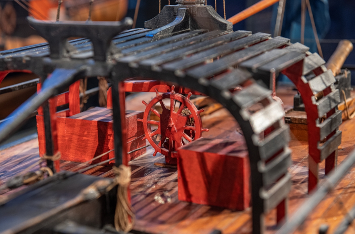

Place the central deck and prepare the bow and stern castles, which I will place last, after I have mounted the cannons and other elements on them.
The central channel is installed, the stern poop is made, and the cannons and castle railings are mounted. The rowers' seats were prepared with 1x3x20 mm wood supported on a 0.65 mm wire.
The cannons were turned with a total length of 30 mm and a larger diameter of 5 mm. The 1x12 mm wood carriages. In the same way, nickhooks were made.
The mainmast and mizzen of 5 and 2 mm diameter were lowered to give them a conical shape.
For the poop, 2x2 mm rods were bent until an inverted “U” was obtained and a central reinforcement was placed; Closing elements were aligned and mounted, as well as the reinforcements for the mizzen support axis and support for the lowered mainmast.
The stern and bow castles are assembled, as well as the poles, railings, nickhooks, and the stern poop.
Using the colors of the model in the museum, the elements were painted with a dark red and black, the rest was left in walnut color.
