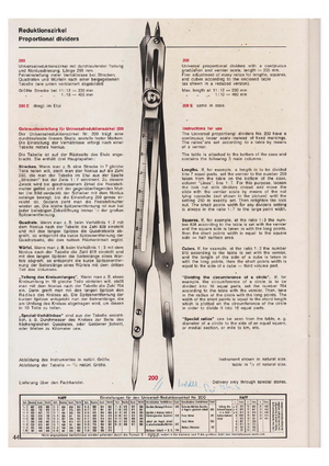

In the above image, the device is not mine, the purpose of the show is the scale table. I bring mine from the USSR, and, it doesn't have sharp pointers.
it is straightforward to use, and, the tool to increase or decrease the given size from the draft's scale to the scale you need, You will need to set a conversion on the slider, then measure the plan's object with one end, the opposite end will give you the scaled size.

If you work from drawings to the scale you are building (i.e. as with kit plans,) you can live without a proportional divider, but if you are working from plans in one scale (or no scale, as in many lines drawings found in old books,) you will be amazed at how you ever before lived without them. Yes, you can measure a distance and then punch that into a calculator and then measure off the result, over and over again, or you can set your proportional dividers once and then simply measure the drawing at one end of the dividers and have the proportional distance simultaneously provided between the points of the other end of the dividers. It doesn't get any faster or simpler than that.
Haff drafting instruments company advertising page and instructions for use of Universal Proportional Dividers. The finest, and near-only, drafting instrument manufacturers in the world were a handful of companies in Germany and Switzerland. One of these, Haff, made all of K&E's Paragon line, labeled for sale in the U.S. under the K&E label. As the prices were stated in euros, this advertisement was after 1999. Twenty-five years ago or so, they wanted 200 euros or about $200 for one retail.
