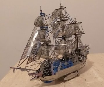

Well, for learning I got a metal kit from Ali as a warm up, one afternoon and Flying Dutch model was ready :) .

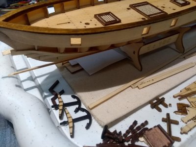

So I decided to order 7$ Halcon 1840 kit from Ali, to just check my ability in such modeling, I didn't know what I am stepping for :)
Kit was typical, bad instruction, my modeling experience was equal to 0.
Anyway I started to look at some movies at You Tube and look for some pictures over the internet.
I found an old water glue in garage, already got sharp knife and start my modeling adventure :)
First of all I did some light wood coloring, for deck and some more intense for other small parts to have them in contrast.

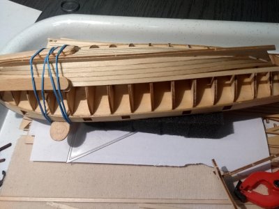

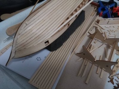

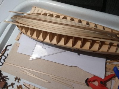

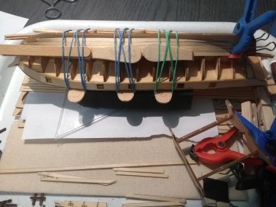

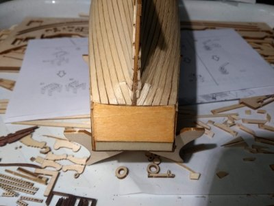

Then I started planking.
Well as for first try I was proud of my work, however there was a lot of imperfections.
Anyhow, a hull need a sanding, so I got a sand paper and sanded a hull, that was nice experience when feel under fingers how wood surface becoming smooth :) .

What was absolutely bad looking in this model kit - cannons made as flat parts, so there was some thinking, how to made a nice cannons.
Firs of all I had idea about 3D printing, but there are still plastic, and as second I was lazy to change filament in my 3D printer from white to black color.
There was also idea to buy a ready made cannons from Ali, but finally I bought a lathe for wood, there was some promotions for 25$, good deal :)
I used iron rod 6mm to set inline of lathe (bearings are 6mm inside diameter), and after first try I was able to made a middle deck big cannon, I was so proud, my first in life lathe use :) . As material I used a stick from water ice cream, they are exactly 6mm external diameter, so fit in bearings perfectly.
After using black marker, the cannon looks pretty well :D
After such nice try with middle-deck cannon, I try some small cannons made, finally I used broken knife as template for cannons body made.
I decide that such dimension is OK.
Lastly, as I learned from this forum, that I have to fix anchors, to twist them 90 degree, so I did it.
I added also some ropes/lines for cannons and glue all 10 of them at deck, added fixed anchors also :)
For anchor I made a small hook to keep them up.
