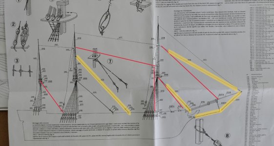

The kit plan as shown below has some strange ideas about rigging. I'll be candid, some of it is complete nonsense. On the other hand, I can see what the designer was thinking about when I compare the kit plans to the French archival material. Also, I never thought that it was a practice to stay lower masts in the rail (not that I know much and what I know wouldn't fill a thimble), but the kit got that part right!
Here's what the kit shows:
Below the red lines represent where stays should be based on the L'Orenoque's sister ship Panama. Yellow highlighting shows the nonsense. Note, however, that based on Panama , the kit's direction to stay the main mast in the rail is accurate. I just don't get why the same diection was not included for the mzzen mast.
You notice that this drawing of Panama shown no preventer stays. Well, I'm adding them to my model.

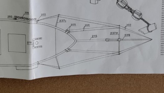

As to the bow - the kit plan is completely wrong. Initially I thought that it made the head of the ship look like a radio mast from the late 1800s early 1900s. What was the designer thinking with this nonsense? Well, the French archive plans show a similar idea. Perhaps that is what the designer was thinking about.

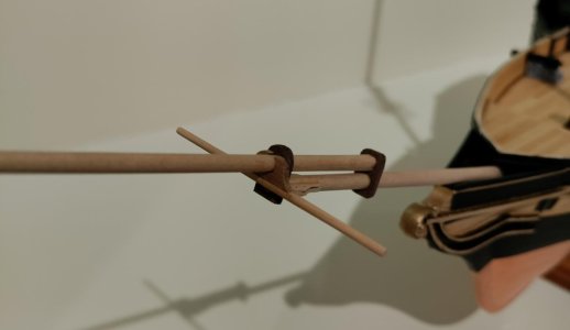

I'm going to follow the French plan with one exception. The spreaders for the shrouds are hooked to the bowsprit. I made my bowssprit and jib boom before I found these plans. My version with the spreaders on a single spar is based on my resource books about masting and rigging clipperships which accorded with the spar shown in the rigging plan.
lo jib rigging spreader 4.jpgWe'll see whether I do over the bowsprit and jibboom a third time.:eek:

Forestays in the water channels is something i have seen before,quite often, (i think it makes foremast gaffs easier to tack, my Amphion is rigged this way) but here it would be essential because of the position of the funnel . L'Aigle is stayed the same way while le Sphinx runs them right out to the wheelhouse sponson decks. Older non steam rigs often had twin stays running either side of the foremast to the deck in front of the taffrails.
