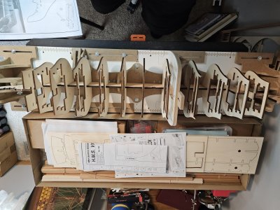

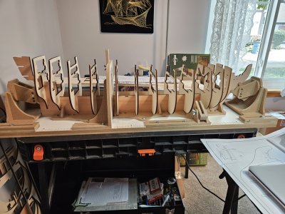

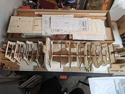

Ok, finally can get going on the build and log. One thing I've really found out is the char on their laser cuts is horrible. Some pieces are worse then others. Mess aside though the fit of pieces to each other the fit is remarkable
found out something interesting today. The nicest ship berth out there also has the ultimate in lousy instructions.
Jim, when I looked around for that build slip (bad instructions aside) I was impressed but dang if I could find anyone who had it in stock (other than across the Atlantic). Where did you find yours?
Hi Bill. I bought it from Hobbyworld-USA in Watkinsville, Georgia. It was $75.00 plus $49.00 shipping. I'm just starting using it, but even with the steep shipping cost it will be worth every penny it cost many times over. Good luck. Jim
