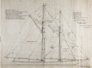

In addition to the L. B. Jenson measured drawings I have been looking at three other model ship plan sets. The first was drafted by H. W. Porter in 1940. The second was drafted by Phillip I. Eisnor in 1988, and lastly plans offered by Model Expo, Bluenose MS2130. The Model Expo plans are the ones in the Model Shipways 1:64 scale kit. I do not know the providence of the Model Shipways plans, but am interested to learn.

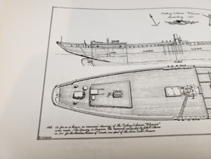

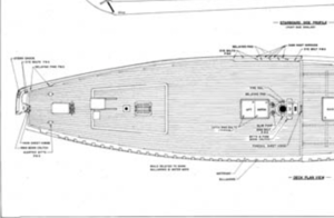

When looking at all of the collected research materials, I am most concerned with the discrepancies related to the shape of the ship’s hull. Particularly differences in the aft end, the shape of the transom, the curve of the bow and the shape of the rudder. L. B Jenson’s drawing show a Bluenose with a very sleek, streamline aft, ending in a small roundish transom. Whereas, the other three sets of plans show a standard Gloucester Schooner aft end, not so tapered, squarer when viewed from above with a wider oval transom. Also, the rudder shapes are quite different. L. B. Jenson’s drawing shows the rudder with its center of area higher than shown in any of the plan sets. The bow of the Bluenose, according to L. B. Jenson, corroborated with pictures and videos of the original Bluenose, has a profile with a smooth curve with a constant decreasing rate of curvature fore to aft. Whereas a couple of the other plans show an abrupt change in the rate of curve at the bow commonly seen in other schooners.
Let us start at the aft. Compare the top views of the aft end of the Bluenose focusing on the narrowing of the shear and the shape of the transom:
The original Bluenose from L. B. Jenson’s drawings:

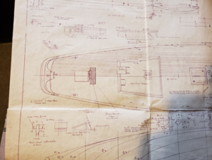

From H. W. Porter’s 1940 plans, the rear is squarer and wider:

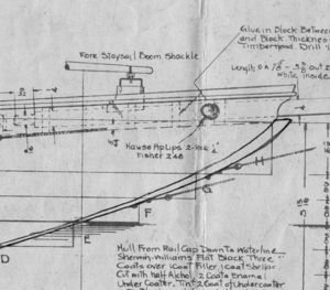

Phillip Eisnor’s plans similarly has a square aft:
Found here: http://www.modelshipbuilder.com/page.php?26

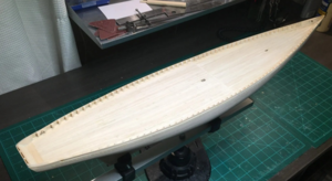

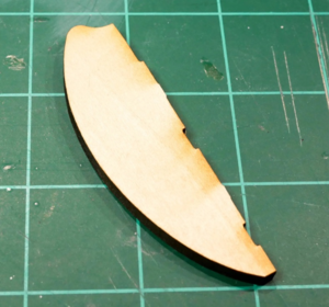

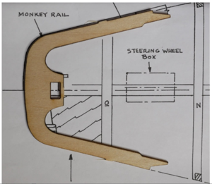

And the Model Expo plans aft end:
The squarer aft in the Model Shipways kit:
The last two pictures are from:

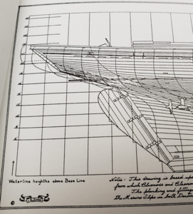

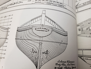

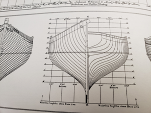

Comparing the transoms:
from L. B. Jenson’s drawings, the transom is almost heart shaped when viewed from the rear:

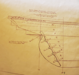

Now, the rudder:
L. B. Jenson’s drawing of the rudder:
From H. W. Porter’s 1940 plans:
Phillip Esinor’s rudder:

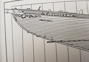

Now let us turn our attention to the bow.
In Phillip Eisnor’s plans and Model Shipways plans there is what I call a “knee” in the curvature of the bow. This is a section where the rate of curve moving from the bowsprit down the keel, abruptly increases, then decreases.

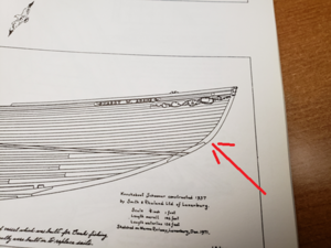

Below is another example of a schooner, the “Henery W. Adams” that has the “Knee” in the curve of the bow. It is like there is an almost vertical cutwater that then curves into the keel at the “Knee”.
Below is the model shipways kit, also with this “Knee”:
Interestingly, the plan set that comes the closest to L. B. Jenson’s drawings is the one from H. W. Porter. There is no “knee”, but the bow looks more swept back than the original Bluenose:
Below is the drawing from L. B. Jenson of the Bluenose bow. The curve starts at the bowsprit and as it moves down the keel the rate of curve decrease, that is it flattens out, without the abrupt change in direction of the rate of curvature. There is no “Knee”.
