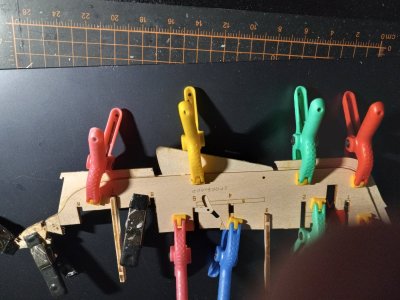

If you are going to try this kit for the first time, there is a very weak point at the stern that is very easy to break during the stem assembly.
The second breaking point is also at the stem at the reinforcing pieces C and D. The breakage will occur when you try to add the bulkhead frames 9 and 10. If they are too tight, sand them before sliding them into the slot...these two bulkheads slide in from the bottom and will snap the stem if they are too tight, and you will have alignment problems with the stern, deck, and planking. Don't ask how I know.
So watch the grain pattern on the stem.
Also make sure the bulkheads will clear the reinforcing pieces A and B. You may want to lightly sand these reinforcing pieces to make sure you have adequate room for the bulkheads...what ever you do, DO NOT FORCE the bulkheads. That stem is to the Smack as your skeleton is to your body. Hug it, kiss it cuss at it, but don't break it.
You have two options on this kit for the centerboard, moveable or fixed. I always use fixed because moveable parts attract curious finger as a light attracts moths. But younhave that option.
The number 4 bulk head goes on first, it's tricky and you will have to work it to get it onto the stem properly, at least on this kit, the slot that slides over the reinforcing part B is too small and had to be enlarged. Make sure it is square to the stem.
