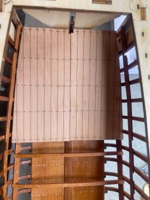

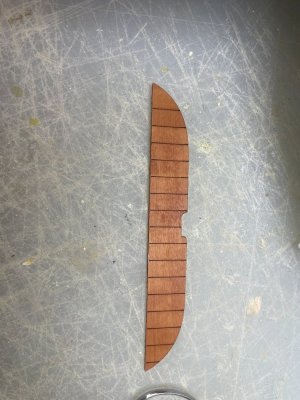

finally able to get back to my little project. I had a journey with the nails in the floorboards. I drilled out the openings a little bigger, but they were loose with the supplied 0.6 mm wire supplied. I got some larger wire 0.75 and 1 mm, and measured my drill bits using a digital caliper. Turns out the drill I initially used was 0.9mm. I didn't like the way the nails were going in and was smearing cyano glue on the wood, thinking maybe this is above my ability. After exploring the option of treenails, I decided to drill both sides to 0.9 mm and simply fill the holes with filler, which turned out OK from my standpoint. See photos below which is before staining but after hand sanding.
