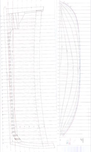

the waterlines in the drawing are close to each other and so it is difficult to loft the frames. I made new drawings with the waterlines in colours. This to minimalize the risk on faults.
