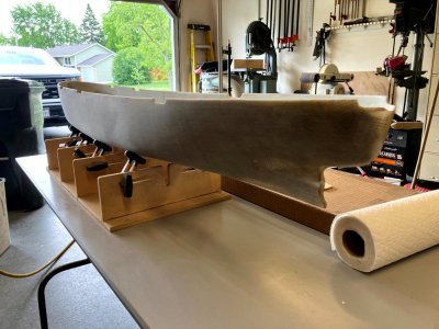

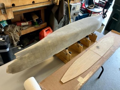

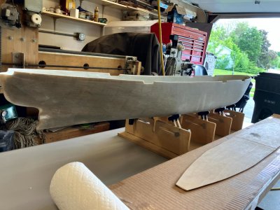

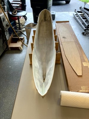

I need one more coat of touchup resin to the outside of the hull but will wait until I cut the existing deck out and can glass the inside. I struggled trying to 3d print the mast swivel joints but finally got them very close to scale. They are a little thick but I need that for strength. The other options I thought of for the swivels were clevis' but I'm having a hard time finding them small enough, the other option was putting together (2) small eyehooks which swivels great but I'm trying to get as close to original as possible.
Finally got a 4 day break from helping my son finish his new house and got to do some glass work on the model. The interior and exterior have final coat of resin but need to be sanded down with 180 grit before I can prime it later on. I got my dumas motor today and it will install nicely once I mount the lower deck. IMG_1033.jpgIMG_1034.jpgIMG_1035.jpgIMG_1036.jpg
