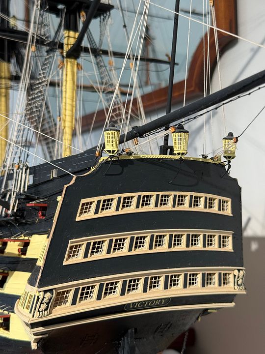

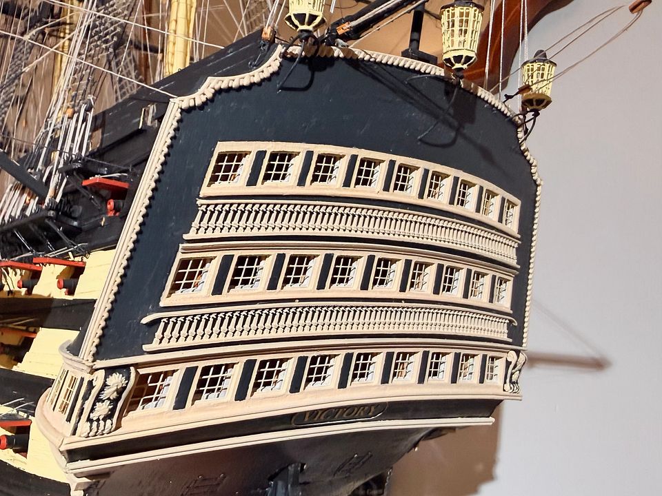

I was not quite sure about the detailing and shape of my already-built Victory transom. The Caldercraft kit uses etched balusters, which is a good way of getting uniformity and very good for a kit 20 years old, but they look rather flat.

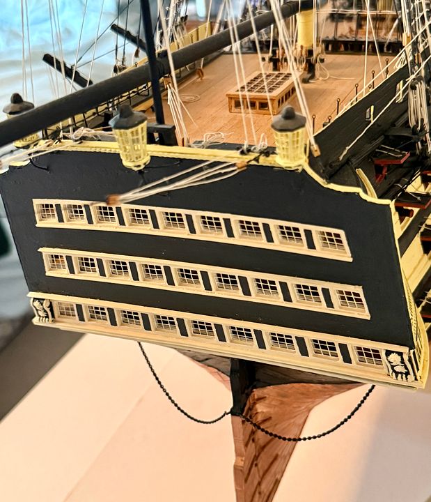

Fortunately, Neil at Woody’s Model Works (https://www.woodysmodelworks.co.uk/store/p1/HMS-Victory-Gallery-Enhancement-Kit.html#/ ) makes some excellent replacement 3DP mouldings for improving Victory in a variety of scales. The first job was to clear away all the kit castings and etches above wardroom level and re-paint the black (actually dark grey).

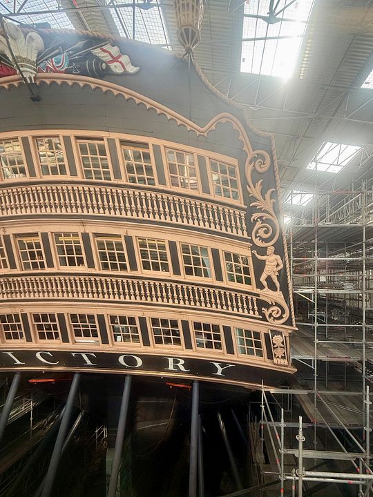

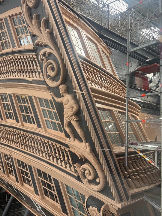

Looking at the prototype, the outer edge of the transom should be parallel with the window frames: it wasn’t, and so the sides were trimmed away towards the top.
I think it has a much improved appearance with the ‘shoulders’ trimmed.
On the side of the transom there is a fine vertical triple moulding which becomes part of the peripheral rope decoration on the stern.

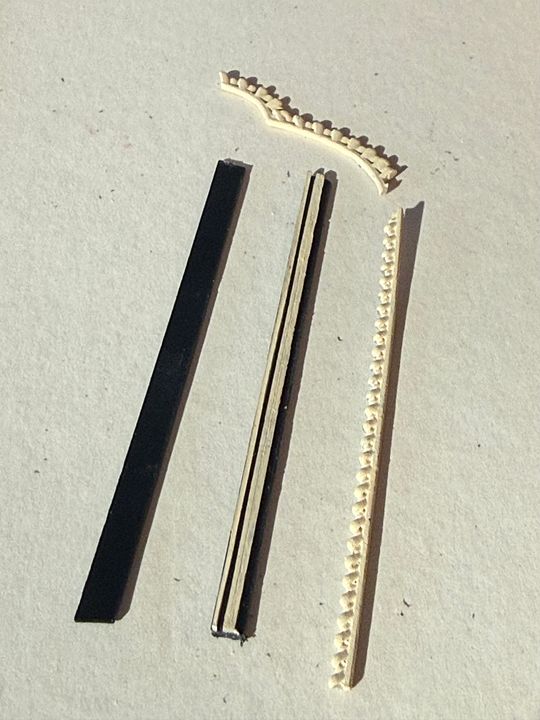

These rope mouldings are available from Woody’s and were then fitted along with the vertical mouldings cut from buff coloured styrene sheet, glued to a 20 thou black background strip.
As fitted along with the excellent baluster mouldings

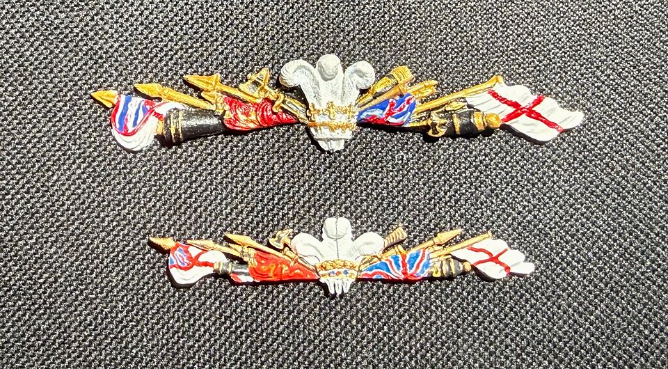

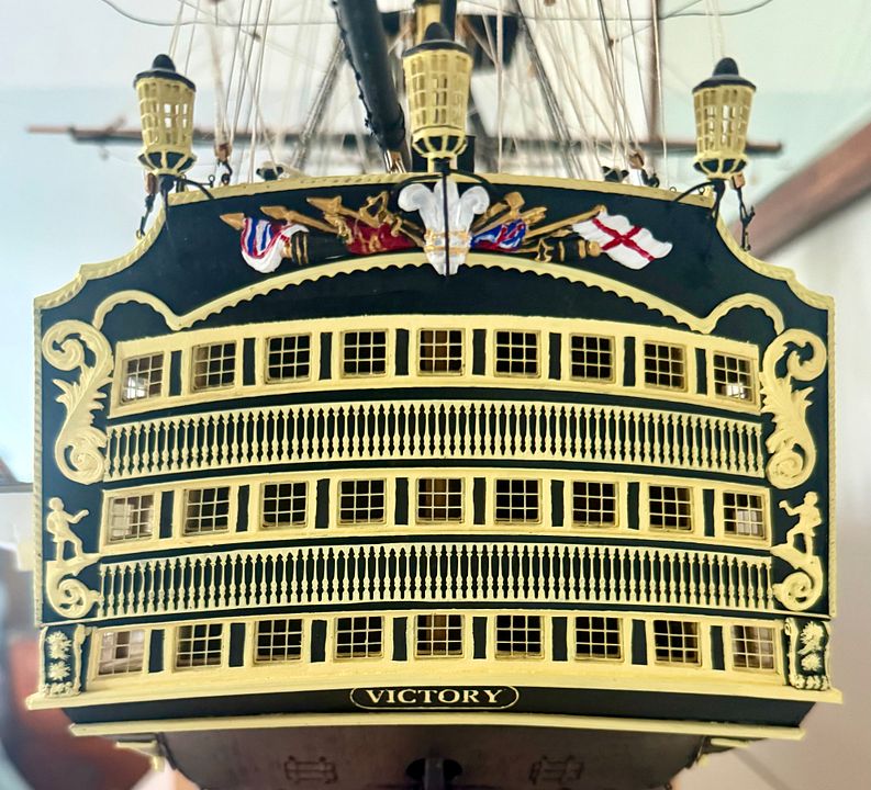

The Trophy of Arms was the next consideration. The original white metal casting (top) is much too big and so was replaced with a 3DP.

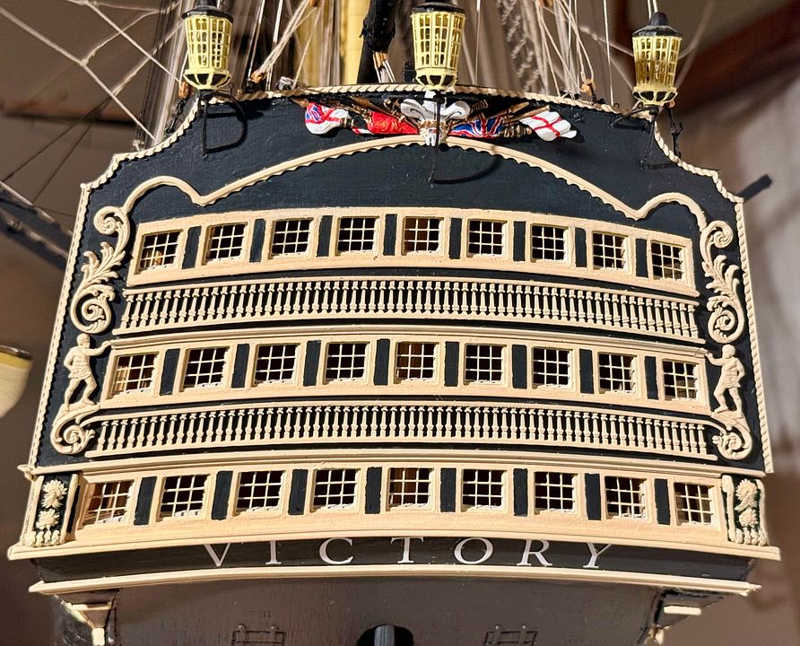

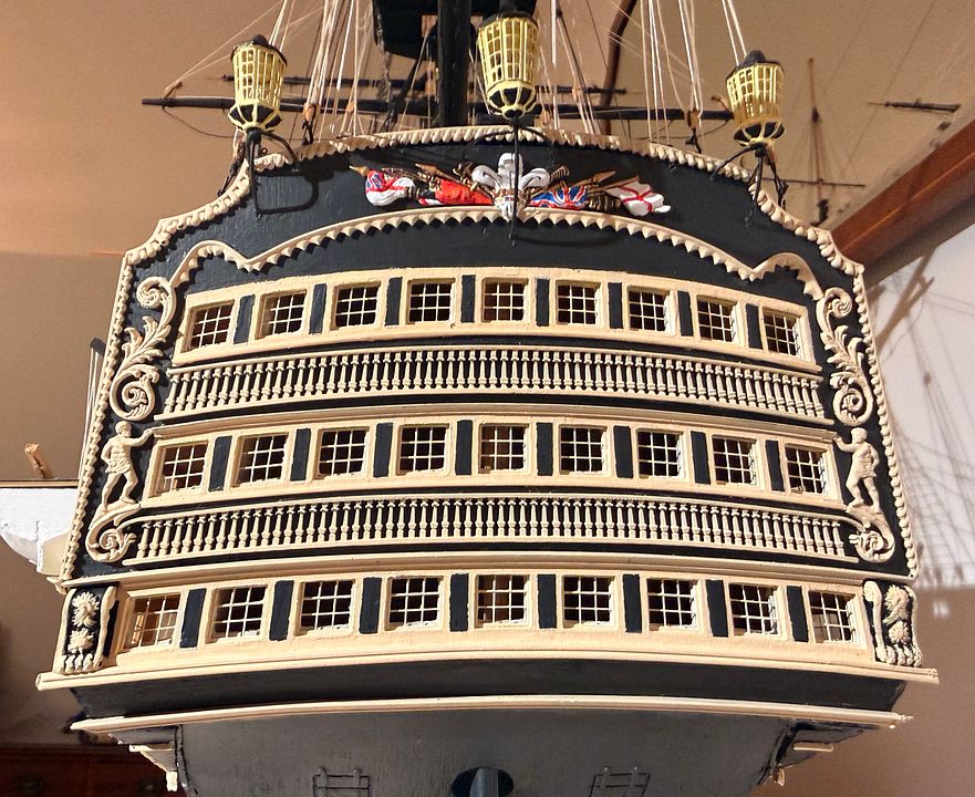

This is the appearance with all of the Woody’s mouldings fitted:

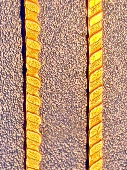

However, when I compared this against the prototype, the rope decorations were a bit oversized, the shark’s tooth swagger was of the wrong pitch (too many teeth per inch) and the Trophy of Arms came in too low. Fortunately, the Caldercraft etchings are the correct size but need a bit of refinement to make them more convincing. The inner edge of the rope decoration was filed into a notch every twist using a fine needle file.

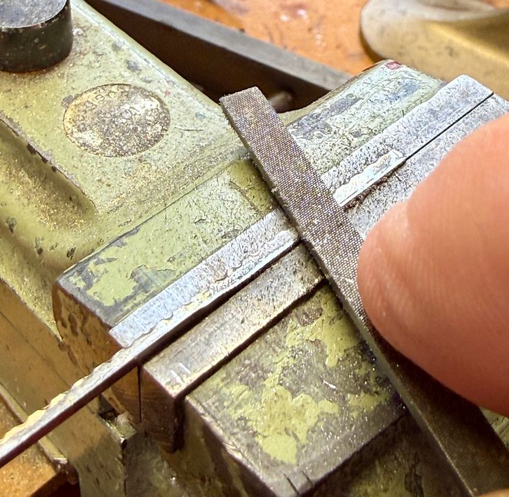

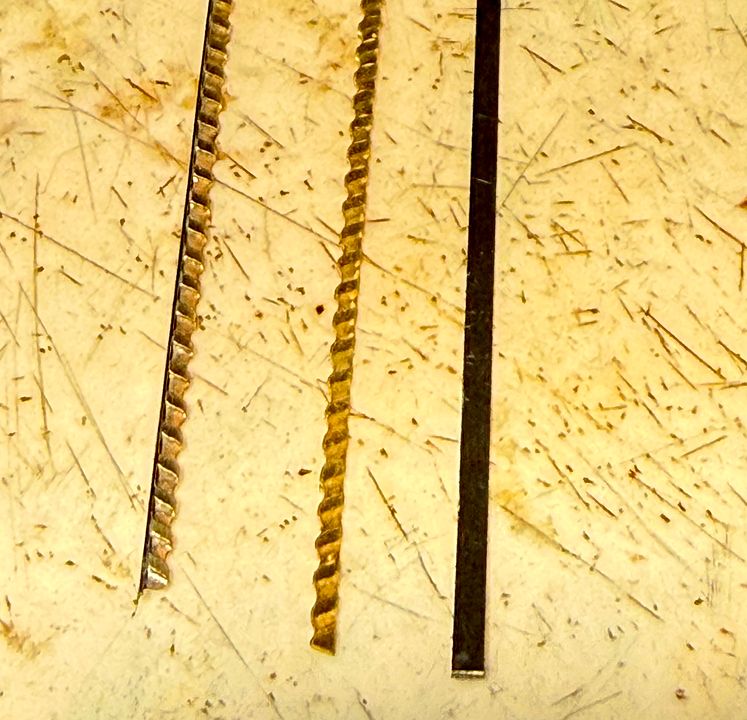

The vertical rope twists had metal strips soldered to them so that the triple vertical moulding would maintain a visually sharp outer edge. The decorations were therefore soldered to an over-width strip (tinning both components before soldering) and then the excess parts of the strip filed back until it was 0.5 mm wide.
Filing down the strip to size.
Meanwhile, the shark’s teeth were sharpened, the top edge rounded and a more pronounced curve bent into the etch so as to push the Trophy of Arms nearer to the taff rail. I was now happy with the transom decoration.
I think that is more than enough for one post! The ‘Restoration’ within the title is in inverted commas because the model was itself really good but I just wanted to make it a bit more as I saw the ship in Portsmouth.
