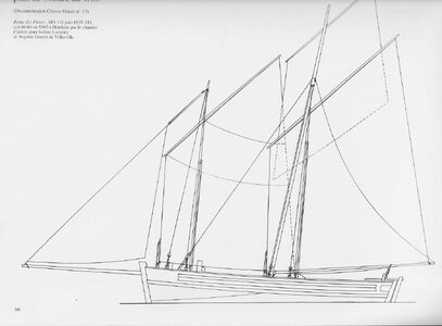

The main idea of this project is to follow the indicated references, the general lines are available, but there is not much information on deck details or the Flambart rig. It will have to be complemented with some photos from magazine articles and a platte model found on an internet forum (modelisme-naval-bois) so I have to take some small liberties.

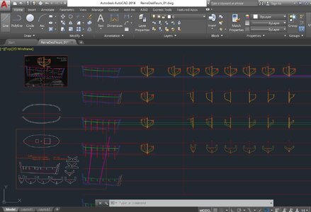

From the plans and lines of the hull, the sections for the frames, the shape of the deck and the dimensions of the sails and rigging were obtained. It was drawn in Autocad and with the PDF file obtained, the false keel, frames and main parts were laser cut on a 3 mm plywood sheet. Also using Autocad, the dimensions of other minor elements were taken and redrawn freehand on a workbook.

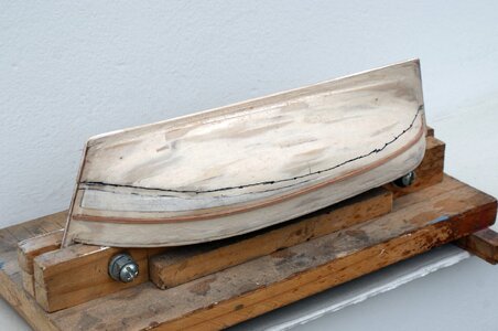

Once the cut plates are available, the parts are disassembled, sanded and presented; They are glued with white glue, realigned and mounted on a frame. In the closed parts of the bow and stern, pieces of balsa wood are added that are cut to the shape of the hull and so that the strakes can easily sit. Afterwards, the frames will be sanded to shape them and receive the 5mm strakes. I will prepare the strakes for the hull, 2x5 mm cedar strakes were used for the entire hull up to the bow. The wood I used was terrible, it was a very hard or stiff cedar, difficult to cut and bend, and the grain was not straight (1 in 2 broke). I finally finished it and the finish of the 1st lining was ugly... but not so bad that a good sanding would improve it, I did it and putty it twice, the first with a mixture of sawdust, white rubber and putty, the second with an acrylic base, It was sanded again and painted black on the outside and green on the inside.

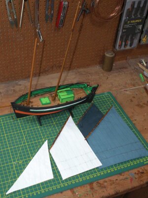

The roof continues to be made with 4x100 mm veneer slats glued on 1.5 mm plywood, glued on the frame and after being painted in dark green. The sides were taped and a line design was painted in orange, white and green. I prepared the various masts such as the bowsprit, the foresail, the mainmast, dyeing them all with a honey color; also prepared the rudder and its tiller, the cellar entrance, the cabin entrance, the dead eye and their chains (0.25mm twisted wire); the anchor and its winch; all of which were fixed to the deck. The 3mm dead eye were fixed, shrouds of 0.8 mm dark waxed thread were used.
The sails were cut to the measurements obtained from the plan and are made of white paper, with a layer of paint. Three colors were used, white for the jib and foresail gaff and two-tone grey-green for the mainmast sails. The ropes of different caliber, dark 0.8 mm for the shrouds and 0.6 mm for the hoisting of the outriggers, light colored 0.45 mm for the working rigging and 0.30 mm for the halyards. In this last part, photos of the finished Platte are presented.
