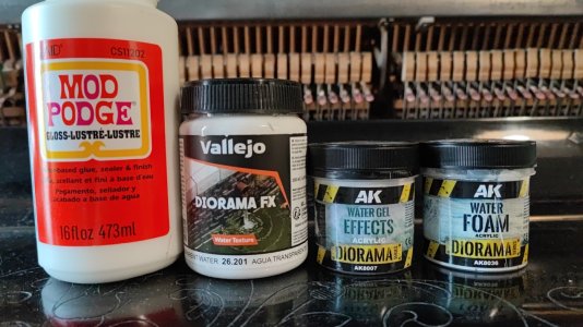

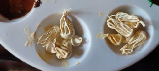

My ship&diorama ingredients speak for themselves. Amati is a good, affordable supplier of gun ports, cannon, ladders and stairs, ornamented strips -- anything made of metal, really. Sometimes I get the scale wrong, but those I'll bury in the sea bed as treasures.
Mod Podge is decent for water sculpting and it comes in a generous jar. The Vallejo brand is superior in my experience: it gives me crystalline transparency, while AK provides the opposite: wild foam.

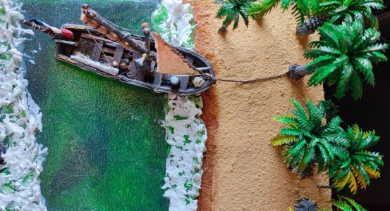

The mini-wreck, I put together plank for plank, but the hull of the captain's boat is one metal form; I'm not much of a masochist. In the board gamers scene, who have a shop and player's club in every city, I purchase tufts of grass, tiny gravel, and for the beach a sand imitator that basically resembles solidifying peanut butter. It is stunning how some of those players construct, paint, and ornament their pawn hobgoblins or witchland game maps.
I buy the cheapest Chinese boat set in the same 1:100 scale as my Ochre Galleon, which is an affordable way to get extra sails, deck grids, planks, and a few guns. I have decided to give my galleon an extra gun deck, plus two shooting out the stern, to go from the buccaneer's 12 cannon to 29 in my Dutch galleon.

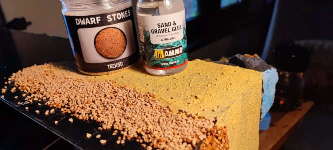

Finally, a visit to a model railway shop gets me water sheets, rock sheets, fake rocks, and 1:87 (H0 scale), tiny dogs, cats, and sea birds. I absolutely must have a beagle on deck, her nose in the evening breeze.

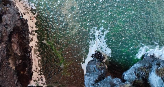

With a box cutter, I slice diagonal lines in the surface of the blue sculpting foam slabs. Then I deepen and soften those sharp slits by rubbing a small stone along them. The deeper crevices are painted dark and the outer surfaces lighter. Glueing bits of this foam together is best done with an upholsterer’s glue spray that spews out creepy silvery nets of goo that stick like hell. I take care to lock my cats out of the room first.
Phosphorescent paint is produced from phosphorescent powder, so I buy the powder directly, in different hues, mix with latex paint, and brush it onto my water plants (bought in an aquarium and fish pet shop) and onto a set of 3D printed jellyfish that I will glue to the bottom side of the water sheet, to be suspended in LED light.

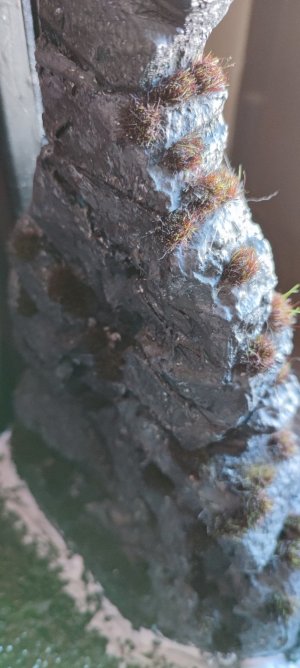

Finally, four big fat plastic decorative pine branches used in fake floral arrangements from a Christmas decoration shop, each as big as my hand, are just right for coarse weedy underwater plants, also to hide the wiring under.

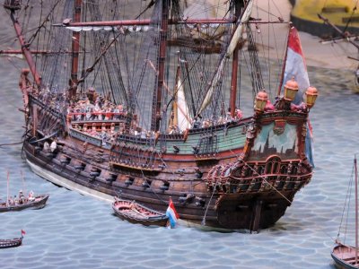

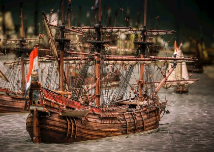

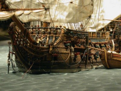

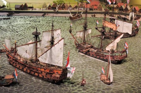

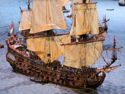

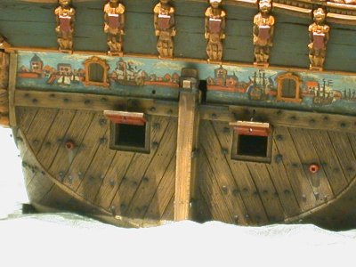

HISTORY: DUTCH EXPLORATION, NAVAL BATTLES, AND COLONIAL ACTION
(The pictures in this section are from De Rede van Texel, the world’s largest ship’s diorama on the Dutch island of Texel.)

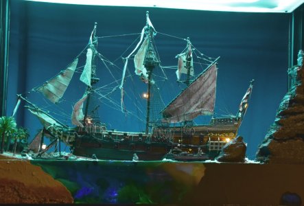

The ocean box is now done, and around the whole thing comes a glass display case.

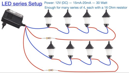

The candle-lit lanterns with their distinctive, timeless shape, still seen in a thousand parks and town centres today, are available for train sets in two sizes, with bright tungsten LED lights inside. I apply a thin layer of ochre with Warhammer paint on the white plastic to get warm and gentle light.
Then I proceed to blow up all the lights in the hull with one stupid voltage overdose. But what an impressive flash it was! No, I do need to work on Ohm’s law and calculate. But how do I get back inside the hull for new lights and new wires?

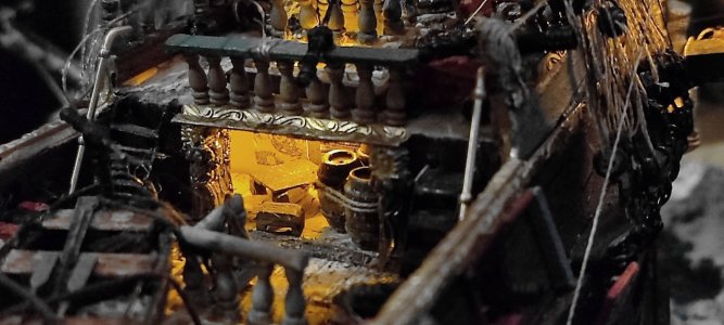

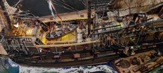

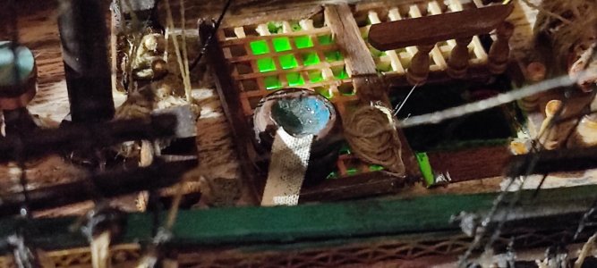

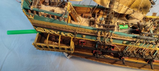

I drill a 5mm shaft horizontally through the ship, just under the deck, through which I lead a straw with the lights inside. Plastic straws are possibly still available through Tor on the dark web for hefty crypto, or at Russian dealers across the misty bridge from where I live. I cut little holes in the side of the straws where the light needs to peep through below deck.
The wires are led out of the bow of the galleon, painted black, where they weave into the fishing-nets. The nets reach the ocean floor, where the wires continue, fusing into the electricity mainline. It’s all obscured by plastic aquarium plants.
The effect in the map room (above) is quite pleasing.
I order 50 lights in different hues as options to play around with, with 15 of them already inside tiny plastic lanterns. They're super cheap.

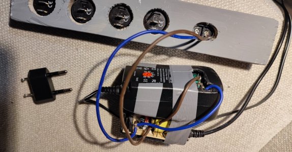

One adapter provides 12 Volts DC at 30W. The 3mm and 5mm LEDS take around 2.8V (depending on colour and temperature). Those LEDs must run in series of four, meaning the currency is led in a circle through them all, the way Christmas tree lights work. I solder a 16 Ohm resistor into each loop to prevent further blowouts (doesn't matter if it's on the + or -. I make sure the solder melts onto the stripped wires gently after I’ve coiled them together.
Four such series connected to the 12V adapted don’t even need more than 1W. Twelve lights overall should be enough for blue ‘under water’, yellow and green inside the hull, warm white on the deck as candled lanterns, and a red one on the beach as the dying embers of a bonfire.

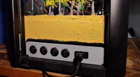

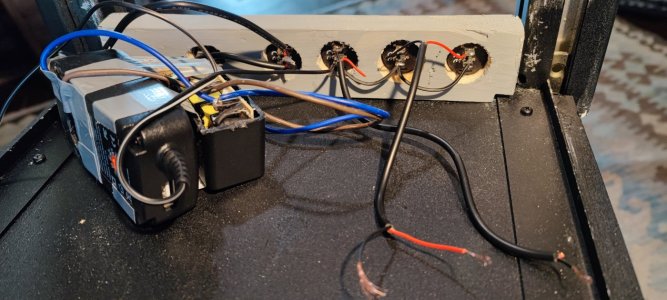

I make a panel with four good-looking switches which will be on the outside of the diorama; each one controlling four LEDs. The fourth will power the LED light snake under the top plank above the ship, with a milky perspex pane underneath, controlled by a remote (which even allows for reacting to sound input).
I still manage to blow up one series when the cables connect inside a straw where they shouldn’t. The red LED wire leads to the + side, and the blue to the -. In the lanterns, it’s black that is + and yellow -. However, if I put the plus and the minus the wrong way round on a series of four, no harm is don: they just don’t work but can be rewired and shine fine.
In the end there's four times a 50-50 chance, and Murphy means I get it wrong each time. You'll never see me in a casino.

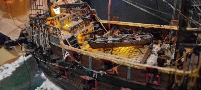

The most important one is the rear deck lantern. Some galleons have three of them, but mine is less sophisticated. I drill through the solid metal lantern that came in the OcCre set from underneath and scrape out the ‘panes’ from the outside. Then I shove an LED up it for a yellow light that bathes the poop deck.
With the remote to the light strip in the lid of the aquarium, I can simulate anything from a dim pale moon to a bright tropical noon, or a ghostly night scene. In green and blue light, the decks take on a graphic, contrast-rich appearance.

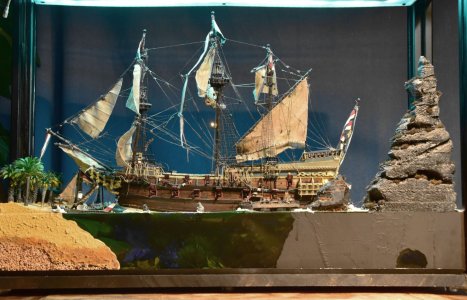

The box must look interesting from all sides so I can turn the thing around from time to time. One side shows the battle damage, the repair raft, the captain's boat and laundry lines, and on the other side fishing nets and a megalodon.
The main job is now done, after nine months, the time it took to build a real galleon once the Dutch had invented the mechanical saw mill. Sure, mine is tiny and won't reach Indonesia, but I did it all by myself, starting with the Ochre buccaneer set, and only this great forum for reference. Reactions welcome!
