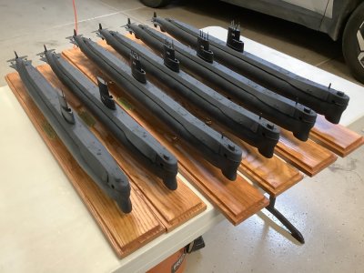

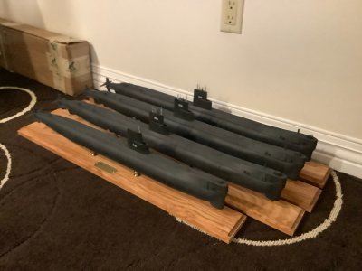

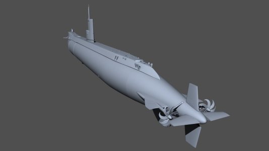

I designed, resin-printed, and built a half-dozen USS Seawolf models to give away at a recent ship's reunion. Finished them in the nick of time in my hotel room before the big dinner and awards ceremony.
Every boat shipped from the Henderson UPS Store was damaged or destroyed. I explained how to pack them, but was brushed off with, "We know what we're doing. . . "
Sometimes, I really hate being right!
Anyway, I'm sending out repair parts for the boats that need them, and re-building a replacement for one that was somehow torn off its base. Maybe they used his box for an impromptu game of soccer in the shipping area, because that takes some real force to accomplish with 3mm screws securing it.
Once I get those sorted, I'll build one for myself.
Lesson Learned: Trust no one. Pack the boats personally.

These are one-of-a-kind, and money won't buy replacements - some of the people who shipped from that office may have insured theirs, but again, who's going to build replacements? I'm shipping one of the extra hulls to a guy (packing it myself in a protective wooden box inside a foam-lined cardboard box) and replacement parts for two who want to try to repair theirs.

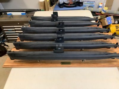

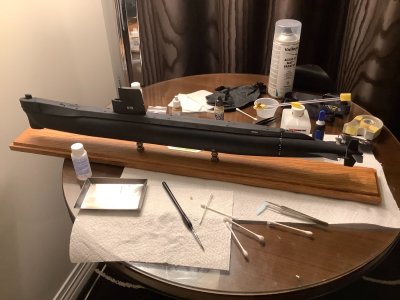

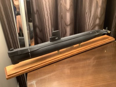

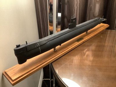

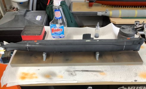

A few extra pics from my hotel room the night before I handed them out. Decals were still setting/drying. Both versions pictured.
Thank you!

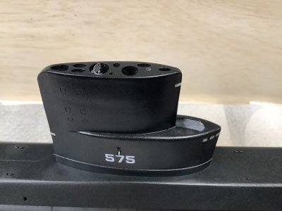

The pictures don't do the model justice. There are numerous deck vents and superstructure lockers included, along with the messenger buoys.

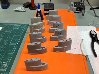

I'm already at work designing V2: A separate bridge deck to make painting of the sail interior and installation of clear sail windows possible. A complete set of masts and antennas for each version, a bow change, and several invisible mods to make it easier to assemble. -Basically, all of the things I wanted to do but didn't have time for to meet my delivery deadline.
I'll post some 3D renders and painted deliverables of the new sails when complete.

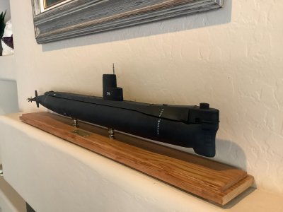

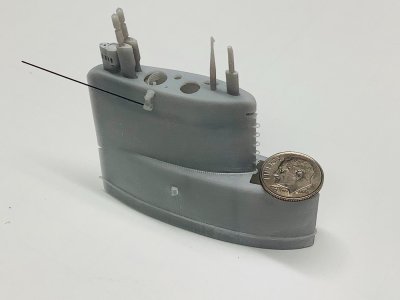

Sail mods went to V3, but the results were worth it. I had one boat (old-style, pre-conversion version) left to ship and originally built it with only a single periscope supplied.

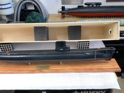

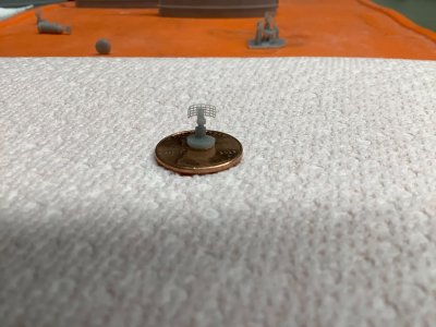

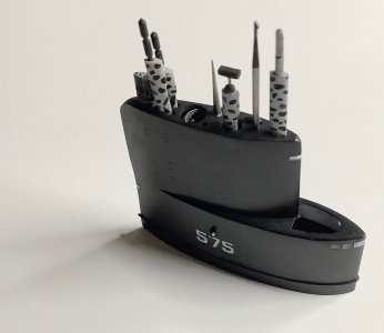

After the reunion, I had plenty of un-rushed time to create a full set of masts and antennas while redesigning the sail. The surface search radar mesh was so delicate, I designed it to remain lowered for protection. The new crate design worked and the ship arrived at its new home unscathed.
I've included a picture of the original hull on my mantle, a shot with the original sail removed, and another with the new sail installed. Since I had plenty of time, I painted the messenger buoys. It was painful enough to redesign the superstructure fore and aft to include separate buoys that are painted first, and then bonded into wells provided by the modified superstructure. They're much easier to paint separately rather than cut masks when painted in place. Clear resin was used to create bridge windows.
