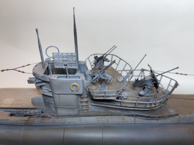

Some years ago I built the 1/72 scale Revell Type VII C/41 and still have that sitting in a good spot in my 'study' (the place my wife allows me to put stuff like that). At that time I already thought about opening up the hull and even bought a few of these cast innards. But untrained hands and work and ... so I built it from the box, albeit I scraped dents in the hull to show the effect of ocean waves on the plating and did a fair bit of weathering. Overall a good model, but still a kit.

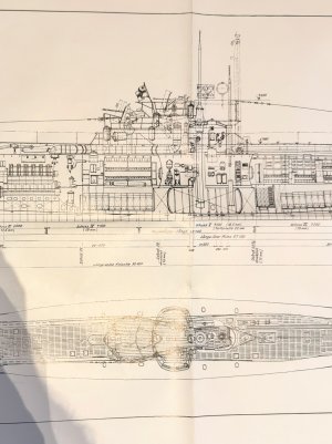

Thinking about a new project I accidentally found the 13 page 'Planmappe: Uboottyp VII C' by Kohl and Nestle. And it clicked: I am going to build the mid section of that U boat, showing all the complexity of the inside. This is the U boat with the 'Winter garden', so with the extended deck and armament behind the tower. It will be from plans, finding my way into the design. Lots of CAD work. I am sure there's nothing like it on the market.

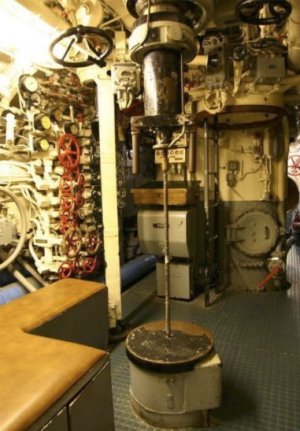

Some images that show my area of interest. By the way: did you spot the British flags on the two U boats? So May 1945 or later.
