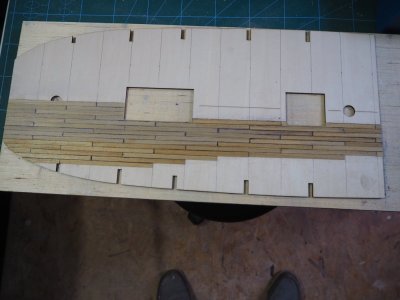

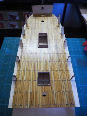

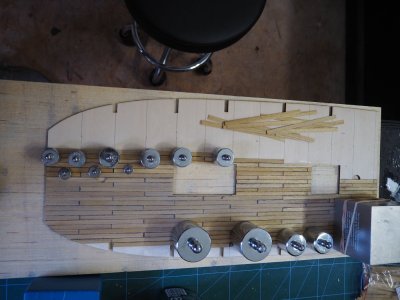

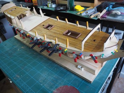

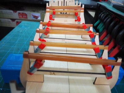

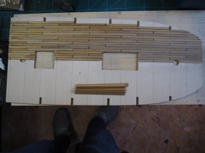

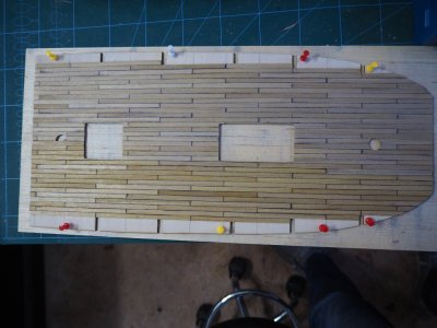

Ok lets start the build, as said previously I will be following the instructions supplied as I am not skilled enough yet to divert from them.

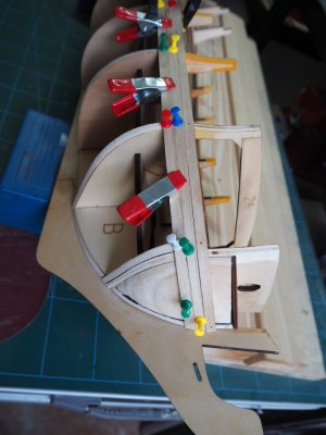

The rib sections all came with a line for filing off which was a great help and a nice touch.
This part of the build all went smoothly, everything nice and tight and only a few that need adjusting to fit.
I had a few problems with the stern and the last few ribs getting them to line though but eventually achieved the result I wanted.

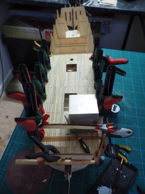

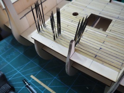

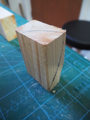

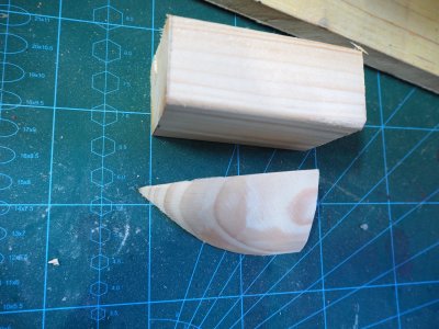

Fitted the thin bow fillers without any problems but I would next time mark up the bow filler blocks off the thin bow fillers before fitting
them as you cant get the pencil in to mark the blocks up after.
The stern went together well.

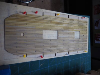

The first deck fitted well without any problems.

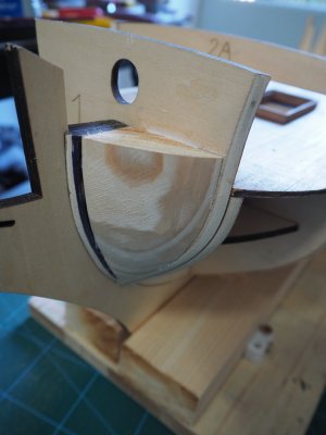

G'day Terry, it's great to see you have started your build log, she is a fantastic kit to build, I've built the Pear Wood version and now I'm building the Boxwood version with an extension piece in the middle.
One thing to watch out for on the ply keel section is right at the back, there is a small tab right at the back end at the top that needs to be removed, see attached pic, or you won't be able to get the rudder up through when the time comes, looking forward to the rest of your build, enjoy,

Thank you for this tip I will remove mine now before its too hard to get too. Much appreciated. I am watching your build with interest and it looks great and moving along nicely
