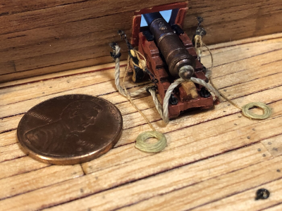

Your guns really do look good. From the photos it appears you went to the trouble of including the cap square hardware with the joint bolt and key. For the future, from Caruana's The History of English Sea Ordnance, Volume 2, only 32 pounders and larger had a double block on the train tackle and running out tackle. Is the black on the trucks supposed to be a metal piece? Metal bands were not used on ships as they would destroy the deck planking, but it was common practice on land based ordnance.
