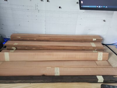

Lumber has arrived!
Should be enough to build the frames and keel, at least, hopefully will take me a lot further. First there's a few boards specifically for finishing the longboat build so I'll be doing that first.
I probably should have been building the jig while I was waiting for the lumber to arrive, so gotta do that as well.
Beautiful timbers, a very nice and pleasant color for steamed Pear (SwissPear). The black timber is Ebony or? What is the source (store\shop) of this wood?
That is ebony, may end up needing to order some thicker pieces depending on the method I choose for planking the Wales.
This, like all my wood for projects is from Dave at Lumberyard. Very nice order put together, took about two weeks to arrive.
