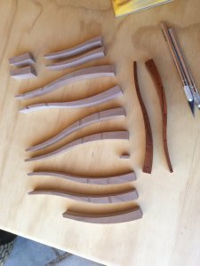

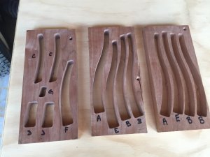

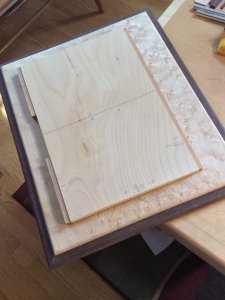

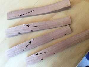

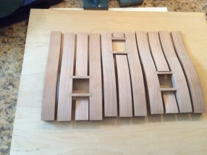

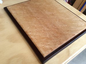

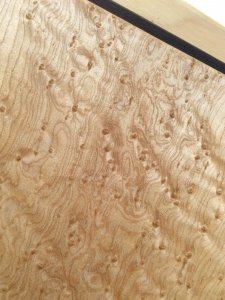

Most of the framing including the hull and deck framing is made of cherry. It's too bad that so much of it will be covered up, but it isn't expensive and it was just easier to cut the parts all at the same time from a limited number of billets, seen or not! The hull framing is 3/4" thick, actually 3/4" WIDE on the model. After CNC cutting, you can see that each piece is held in the 3/4" billet by 2 tiny triangular tabs (arrows). Very easy to remove and clean up the frames. I worked on those while the build board was drying (I glued a rosewood border around a beautiful piece of curly bird's eye maple I had). I also scribed scarfs in the two end frames as well as simulated bolts. I then gave these two a wipe of boiled linseed oil to even out the color.billets.jpgrough frames-tabs.jpgsanded frames.JPG

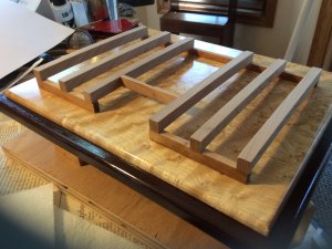

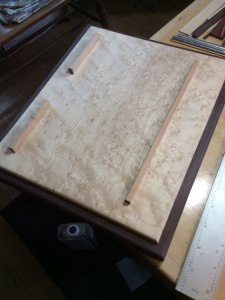

The most important part of the build is squaring up the frame from the bottom. The lower deck clamp must be parallel to the two inboard supports, and the ends of the supports must lie on the perpendicular of each end of the clamp. I drew a baseline, parallel to one edge. I then cut out a rectangle of those dimensions and used double-sided tape to stick the plywood template to the build board. The clamp was exactly as long as the template and the two supports lined up with the perpendiculars. I then glued all 3 parts in place, removing the template after the CA grabbed a bit. Before gluing the deck clamp in place the plans call for a slight bevel of the top surface to the outboard edge. Mike says it was "minuscule" and eyeballed it with his sanding block. Suffering from OCD myself, what I did was blow up the profile of the clamp on the plans, measure the actual angle (4 degrees!) and re-mill the clamp with a 4 degree bevel in the top!!! Will I ever learn?? o_O o_Oo_OIMG_0167.JPGIMG_0168.JPG

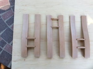

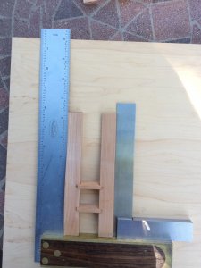

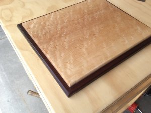

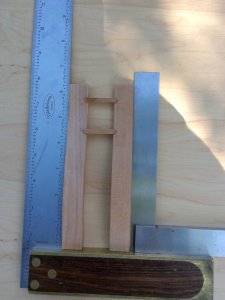

I applied multiple coats of wipe on poly to the board. While waiting for it to dry, I went ahead and installed the sills that frame out the 3 gun ports at the bulwark. The sills are a little oversize in thickness, so they need to be sanded down for a nice tight fit in the frame mortises. Squaring up these assemblies is critical. I used two try squares to get things aligned and some weights to hold the parts until dry. Glue was Weldbond, with some CA applied to the joints later (drawn in by capillary action) for added strength. The sills are proud of the frame surface and need to be trimmed with a sharp blade and then sanded flush with the frames themselves.Img_0169.jpgImg_0170.jpgImg_0171.jpg
