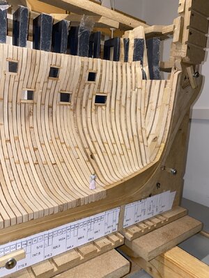

We are building a half model of HMS Defence 1763 Where everything on decks will be visible
can anyone tell me what happened to the crew’s tables beside the canons during battle.

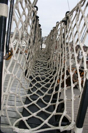

Yes - the hammocks were folded together and stored in the shown nets - as a protection against projectiles from rifles, but they were usually stored there.

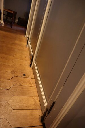

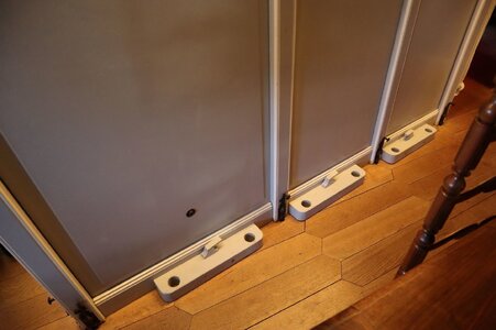

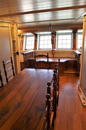

Here some photo of the replica frigate Hermione, where you can see parts of the technique, how the walls were fixed, easy to remove segments

Interesting project you are working:
so I think you have to decide, if you want to show everything "during or shortly before action" or "normal sailing day"

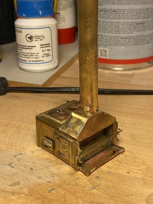

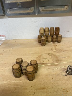

Here’s some photos of the stove and some barrels.

What me now call 'KD fixings'. ;)

BTW very good work on the stove and barrels.
