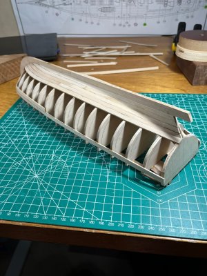

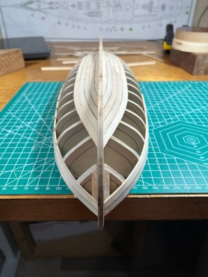

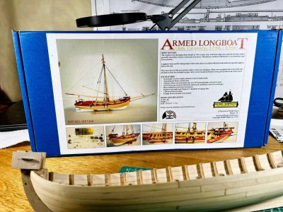

I picked up this kit for free from someone who started it but only got to the keel and bulkheads and then realized they just didn't have the time necessary to work on it. So I disassembled everything and started from the beginning.

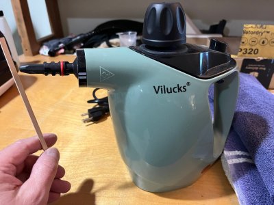

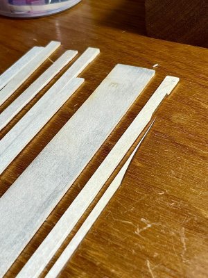

Putting together the keel and bulkheads was fairly straightforward, no different than other ships I've seen here. The planking was challenging. I have experience steam bending hard dense woods but none with such soft ones. I didn't like it. Just a little pressure and you've dented it, luckily a bit of steam can remove any dents or such. A bit too much twist and it crumbles. Unfortunately I found that the wood supplied didn't allow for mistakes and didn't supply enough planks.
IMG_6758.JPEG IMG_6686.JPEG IMG_6691.JPEGIMG_6689.JPEG IMG_6690.JPEG IMG_6694.JPEG

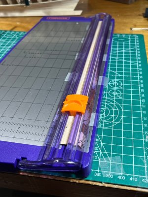

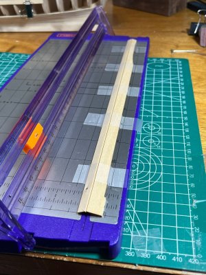

To make up for a lack of sufficient planks I took the left over sections of part-trees, hand planed them down to the correct thickness and sliced to the same plank width. I was able to get a lot of extra planks this way. The problem was after I planed down these pieces, how did I cut them accurately without wasting wood from blade thickness. So, I took a paper cutter that has a guide to hold the shuttle and blade, and that worked great with no wasted wood.

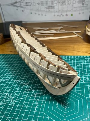

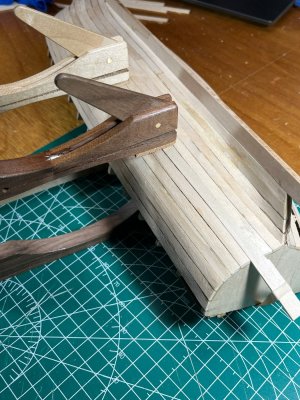

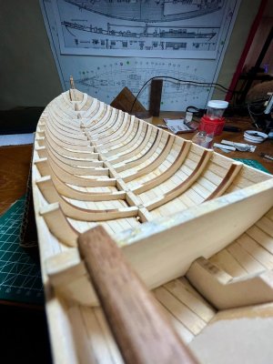

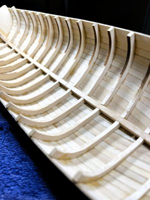

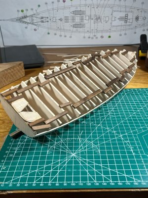

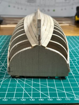

Then came the last plank, but with no more bulkhead for a spring clamp to grab onto. Then removing the bulkheads to reveal the frames.

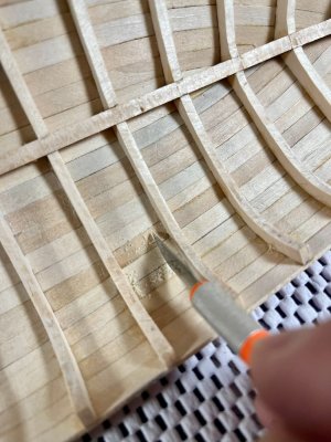

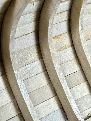

I do have a question for those with more knowledge. Should the inner side of the frames look sanded smooth or more like they were shaped by an adze.
I don't want to make this boat look like it just came off the show-room floor. But more like a boat that's been hoisted many times off and on a ship, run up on shore and hit a rock or two.
View attachment 551458 View attachment 551459 View attachment 551460 View attachment 551465
G'day Carlos, I dont know this particular kit but most ships boats would have a series of floor boards and gratings in the bottom of them plus the seating, I think yours looks quite excellent the way you have it,
best regards John.
