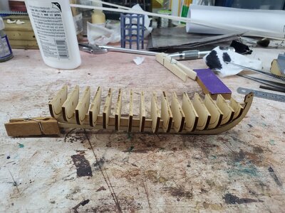

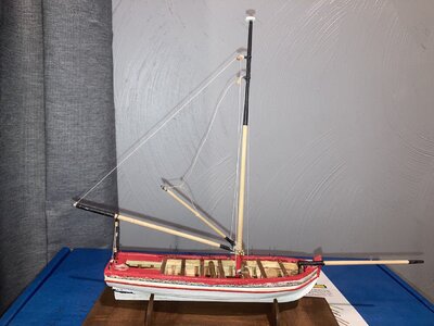

Thank you all for the Birthday wishes. I have been working on my model. I had a learning experience planking the model and took longer than I expected. I did not get it 100% but close enough for my second model. Here are some pictures of my current progress. I am currently working on the two platforms for the boat.
20210527_143900.jpg20210621_152203.jpg20210923_160917.jpg20210926_123226.jpg20211106_140421.jpg20211106_140431.jpg20211106_140442.jpg20211106_140506.jpg20211128_113529.jpg

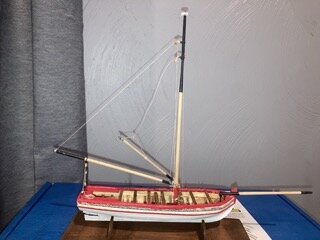

Working on the same build. Newbie here. My first attempt at rigging and it is kicking my ass. Looking forward to seeing the rest of your build. Best wishes, Neil
