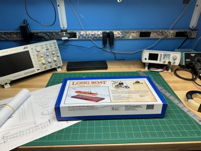

Welcome to my build log! This is my first wooden ship kit. I finally cleared my workbench so I can get started.

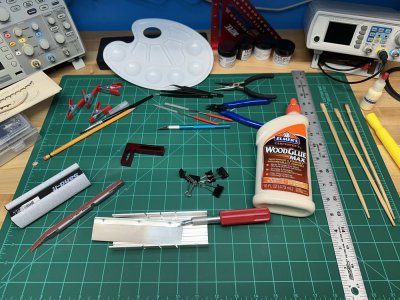

The kit comes with a basic set of tools, paint and glue. I chose to use Elmer’s carpenters glue. I also bought some other tools and supplies.

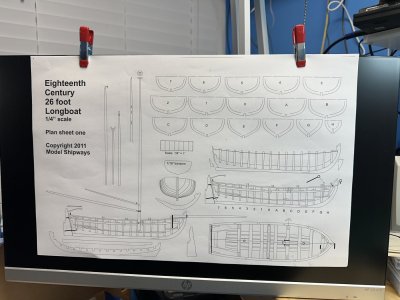

I attached my build plans to my computer monitor which is on an arm mounted to my bench.

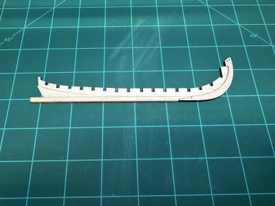

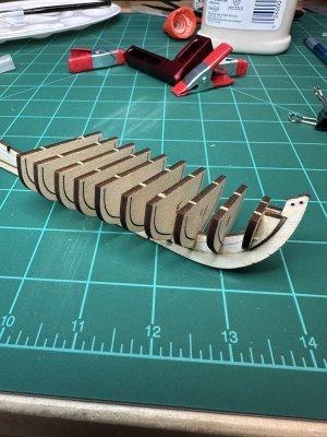

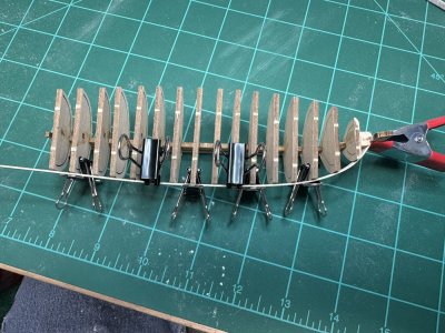

I started off by checking the parts list and making sure everything was in good condition. Next, I started on the keel, I dry fitted everything, created a rabbet and glued it all together.

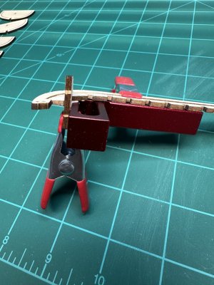

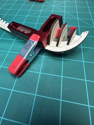

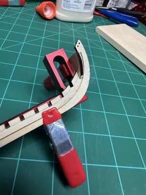

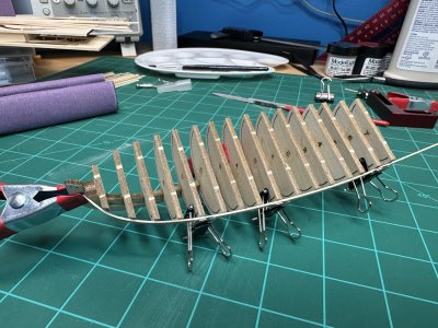

Next, I dry fitted all the bulkheads. I decided to start gluing the bow bulkhead, it attaches to the stem and it was easier to square first.

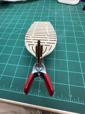

I clamped everything to a small pocket square while the glue sets.
So far I’m off to a good start.

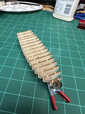

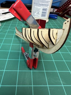

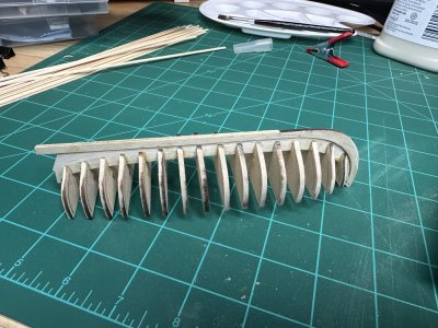

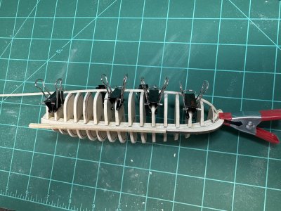

It was a good first day, all the bulkheads are glued in place and I added the front bow fillers. I will let the glue set overnight before fairing the hull.

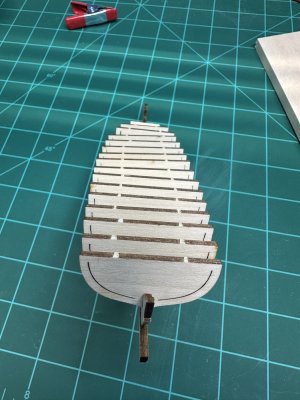

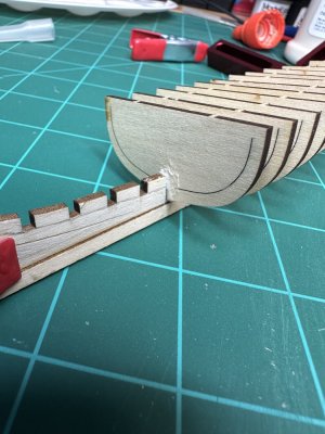

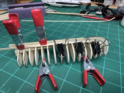

In the above picture, I drew a line on the keel at the bottom of the bulkhead notches so I could see when the bulkheads were pushed down to the bottom. The bottom of the notch is about the same position as the laser cutout on the bulkhead.

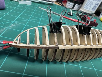

With all the bulkheads in place I verified the alignment, not bad for my first build.
Total build time at this point is 2 hours and 35 minutes, not including time for the glue to dry.
