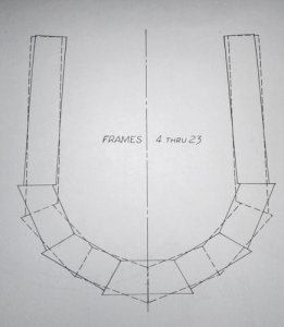

Floor-timbers and futtocks are butted together end to end in 2 layers for each frame. The image below shows the breakdown in patterns for a frame layout sequence: there are 5 different templates / pattern layouts to cover all 40 frames: this is one of them and this patterns is good for frame 4 thru 23 as is mentioned in the image. Depending on the location of the frame on the hull, these patterns change although the number of parts is constant on the vast majority of frames.
Image 001

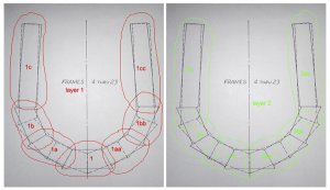

The reason why this technique is somewhat simpler to use is that, by cutting and assembling these large templates / patterns together in 2 layers, the overall shape of the frame is built prior to tracing and cutting the exact final frame as one piece.
Building frames the more traditional way is a bit trickier as each piece to be assembled is much smaller: The frame still has to be broken down into parts (floor-timbers and futtocks) and by layers. Using the image above as reference, I have added numbers to identify parts and layers: everything marked as 1 corresponds to the first layer – 2 is the second layer. I am also adding letter coding to place each part working up the frame. But more on that when tracing, cutting and assembling each frame…..
Image 001 c
The image above shows the breakdown of a frame using the Hahn method of building. On the original drawing, the parts in a layer are identified by being either solid line or dotted line. As a result layer 1 shows parts drawn with the solid line and layer 2 with dotted lines. For this particular frame we note that 13 timbers will make a complete frame: layer 1 x 7 parts / timbers and layer 2 x 6 parts / timbers.
Although I will be building the frames in the more traditional method, I will still be using the same basic breakdown and layering, as the edge of each identified part will constitute the joint between them (parts / timbers).
Once these layers and parts have been identified, one must report that information to the actual frame drawn in the plans. This is done using a drafting compass and a couple of predetermined reference points on the drawing from Image 001 (for example). The result is Image 002 below and the secret is, although it does not have to be perfect science, to be consistent with the reference points, whatever they are: keeping in mind that the joints should be close to forming a 90 degree angle with the edges of the final frame.
The cross lines in 002 correspond to the edge of each part in 001 or 001c.

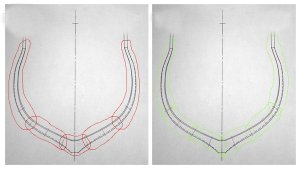

Looking at image 002, taking a count of the number of parts on this frame, you will notice that instead of 13 parts, I ended up with only 11. The reason is quite simple: this is due to the fact that the hull of my model will be planked to a level slightly above the point where the last joint (up the frame) will be located.

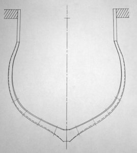

The image below shows the breakdown of frame parts: but I omitted the layer and part numbers: although it is the same as above in 001c. You will note that because the hull will be built up, something is missing in the image. For the members who are not aware of how the Hahn method of framing works, let me just say that the plans are design for the building of the hull up side down. The missing elements in the image are part of the frame extensions that are supposed to be fitted in the building base: referenced in the upper horizontal rectangles at the top of the frame. Building them with his method the frames shown in the plan would be up side down. Hope this makes sense.
Image 002c

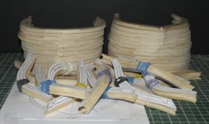

The woodwork really began in the past 2 months.
All 40 frames have been built.
- 27 x full-frames - square to the keel, full double-layer frames.
- 4 x aft half-frame - square to the keel.
- 3 x aft cant (angled) half-frames.
- 6 x forward cant half-frames.

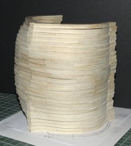

Shown below are the 27 full-frames.
All 40 frames: including half-frames are shown below.
The edges of half-frames still need to be squared on the inside and outside face.
The outside edge of the full-frames have been squared, the inside still need to be done.
