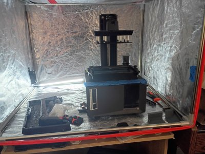

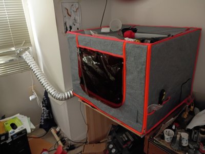

I live in an apartment too I have a resin and filament printers I use water washable resin with very small vapor smell and have a enclosure to vent out the window I bought on Amazon my blocks come out beautiful at a scale of 1/100 I think a fdm printer would be hard for making small blocks.
