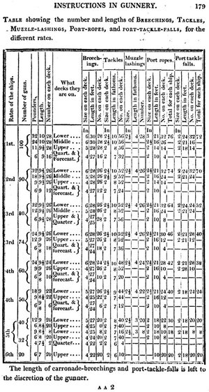

I was also think about the necessity of tackles for such small guns - I have 8 times 3pdr guns on my Le Coureur.
but.....
take a look at the
The Sea-gunner's Vade-mecum: Being a New Introduction to Practical Gunnery
by Robert Simmons, published in 1812
page 177 ff
At the 5th rate you can find 4 pdr guns and given data for the tackles
but.....
take a look at the
page 177 ff
Thank you for your impute, four pound guns are really very small as a youngster I helped with our local yacht club regattas where we used a four pounder firing blanks to start and finish races , it was breached with a 'what I think was a quit thin' rope and then just pushed forward again. As kids we used to sit on it was so small. I imagine the guns on the Speedy would have been easy to manoeuvre and where probably only breached up short and with only single blocked inhaul and outhaul ropes hooked to a ring bolt. I
would like more information, but most pics that I have found are for much larger guns.
