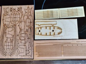

About a month ago I got a letter from HMRC (Her Majesties Revenue and Customs) with a large cheque for an Income Tax rebate. I spent a few days sitting in the garden wondering what to do with this hugh windfall, invest on the Stock Market, buy Gold or splash out on fast women and loose cars. I worked out I could get the 75mm Lifeboat kit from Master Korabel and once the postage was paid I would still have enough left over to buy a bottle of beer and a bag of crisps (potato chips) to help with the build. I like the look of some of the Master Korabel kits but I have always been a bit wary of ordering things from places like Russia or China, so this would be a trial run so to speak. 10 days after placing the order the kit turned up so no worries there then. As expected all the instructions are only in Russian but there is a picture set of instructions and I have been watching a chap on Youtube building the 95mm version so there shouldn't be any problems. I tried my nearby Public Lending Library for "Be Fluent in Russian in 7 days" book but someone else has borrowed it and it's unavailable for the next few months. I have Google Translate on my Mobile Phone and using the camera option I have been able to translate some of the instructions but that's all part of the fun of model building. I will be making a start on this at the weekend and will also be continuing with my HMS Eskimo build

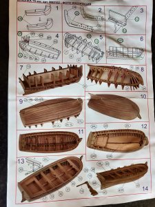

Greenstone, who posts here, is with Master Korabel. PM him and he will send you an English translation of the instructions.
Thanks for that suggestion Dave, I could probably build this just using the picture instructions but there are a couple bits I'm not too sure about,

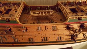

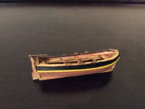

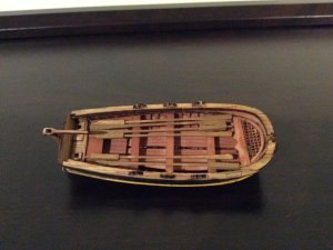

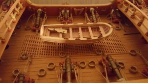

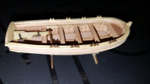

I got this kit from a US dealer on eBay. I modified it to fit my 1/48 La Belle since it was the only wood ship’s boat in the right size I could find other than the inferior boat kits from Model Expo.
It is very well designed and the photos are very helpful although the English instructions can be confusing. The main negative is that the planks and other elements are VERY thin wood and break easily. But, with care it can be completed satisfactorily.
I included a couple of pictures. I still need to add the rudder hinges for which I will use thin artists tape. I’ll also add rope coils and a bucket or two to cover up some imperfections. It’ll be a good added detail for La Belle.

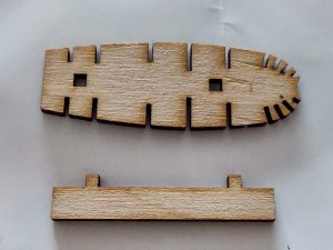

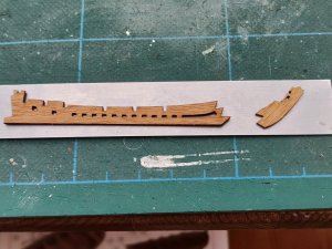

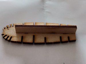

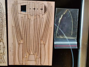

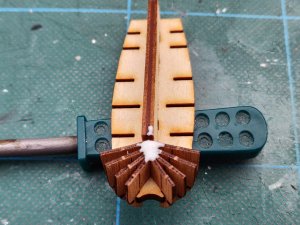

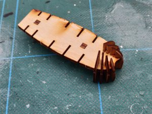

I started on the removable Bulkhead holder, this is 2 pieces of thicker laser cut wood, the fit was perfect without any adjustment required, and I used white wood glue.

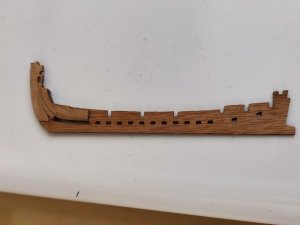

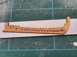

The Keel is also in 2 parts, I cut out the main Keel carefully and using a small needle file I removed the laser char. I did the same with the Stem and then glued the 2 parts together and left for a few hours to dry.
2 small pieces of wood are then fitted, one each side to the front end of the Keel to help locate the ends of the planking strips. These need to be filed down on one edge before glueing into place.

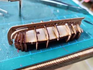

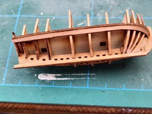

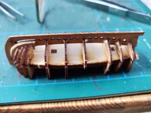

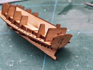

The next step is to fit the Bulkheads, surprisingly they are fitted to the Bulkhead holder that I assembled at the start. A couple of the slots needed a little bit of careful filing so that the Bulkhead could fit without forcing it. I broke one of the Bulkhead's top part but it will be removed once the planking is done . I started at the Bow and worked my way towards the Stern, the fit is that good the Bulkheads all stayed in place except the forward Bulkheads need a "blob" of glue on top to keep them all together (see photo).
Once all the Bulkheads were in place they were carefully dry fitted to the Keel assembly, again no adjustment was required, but you do need to be careful these parts are fragile. When I was happy with the fit I glued all the joins with white wood glue using a wet paint brush to dilute the glue so that it ran into the joins. I am going to leave this for a few days so that the glue can fully harden before the next stage which is fitting the Ribs to the Bulkheads.

A good overview of the assembly of our boat!
It is a pity that you have the instruction in Russian.
The fact is that our products are delivered to Europe, to the USA and Australia already with instructions in English.
At official sellers with it all okay.
And buying from them you are guaranteed to be sure of the receipt of the goods. In time, Qualitatively and with the English instruction.
Of course, I will be happy to help you.
But I do not know how I can send instructions to you?
In personal message, I did not see where to attach the file
We do not have the feature to attach files in PMs....sorry

I have now received the English Instructions from Eugene.
Many Thanks for your help, fantastic customer service.

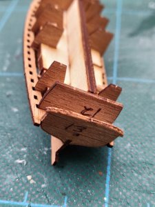

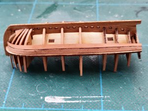

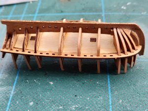

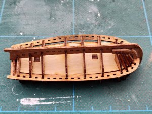

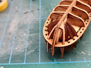

The 2 side pieces were next to be fitted, 1 each side. They fit into the slots on the Bulkheads and again the fit was perfect. They are only glued at the Bow and Stern and I used C.A. gel.
The Stern piece needed some of the sides filing an angle to the laser marks and then it was glued to the Hull.

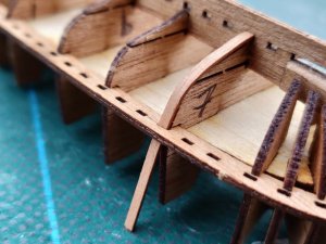

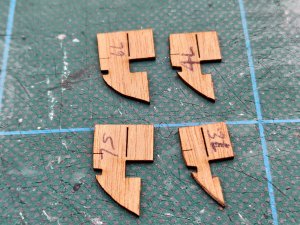

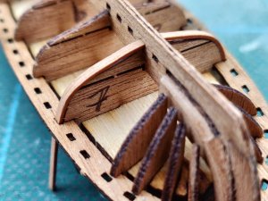

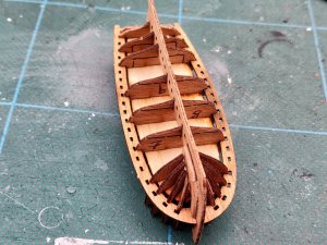

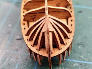

The Ribs are fitted to the outside of the Bulkheads and into the small slots of the Keel and side pieces. The instructions are very clear as to which Ribs are glued where. I started with the middle Bulkheads and first of all soaked the Ribs in water for a couple of hours. I then pushed the Rib down through 1 side piece, throught the Keel and up through the other side piece. These Ribs are then glued to the bottom and top of the Bulkheads with the rest just following the Bulkhead profile.
The Ribs at the Bow are pre-shaped and starting at the forward one I worked my way back.
On the rear 3 Bulkheads the Ribs are only fitted to the top of the Bulkheads, they are glued into the slots on the side pieces and then to the top of each Bulkhead. Once everything was dry I cut the tops off each Rib.

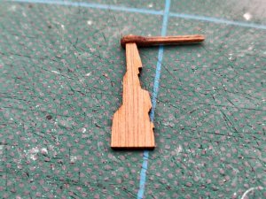

Whilst waiting for the Ribs to soak and for the glue to fully set I made up the Tiller and Rudder. This is 2 parts and simply glue together.

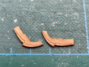

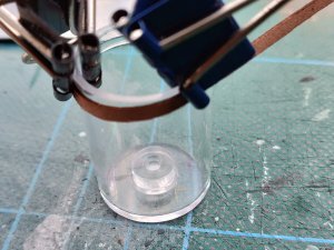

I have now got to the part that I have not been looking forward to and that is planking the Hull. Each plank is numbered and there is a left and right plank. Starting with the plank that fits below the slotted side piece, I soaked it in water for a couple of hours and then clamped the wet plank to the lid of a PVA glue bottle that looked to be about the right diameter. Once it was dry I started gluing the plank from the Stem towards the Stern a couple of Bulkheads at a time using C.A. gel and making sure the plank was tight up against the side piece. Whilst I was doing this I had the top plank for the other side soaking in water. I now have system where I have a plank soaking, one clamped and drying to shape and one being fixed to the Hull.
