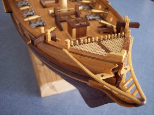

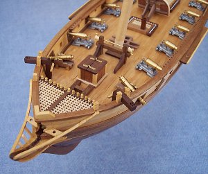

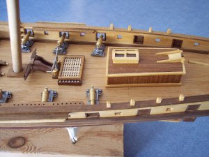

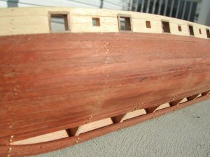

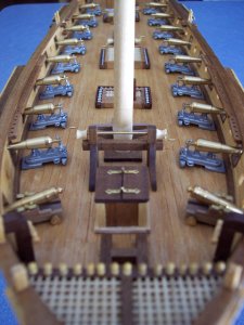

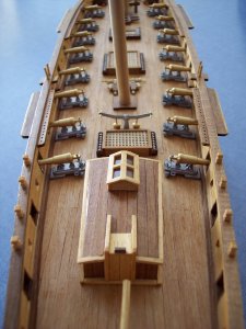

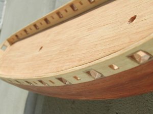

Thanks for the welcome. I'm not very familiar with period ships or nautical terms but I'm trying my best. Here are some early (15 yr old?) shots of my ship build. I've enjoyed it so far, however the instructions, diagrams and photos in my kit are becoming increasingly hard to understand. I'll follow up with newer images and some questions. Happy for feedback (go easy).

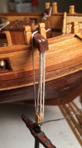

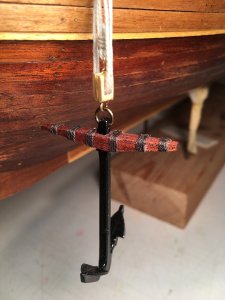

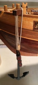

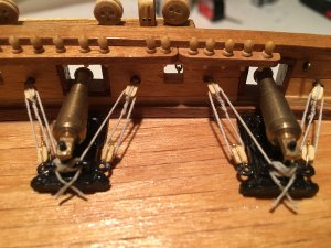

Appreciate the responses. Was a gift from my dad; recently deceased. Crazy, but I feel like I owe it to him to finish this somehow. Did a quick inventory and I have all the pieces, blurry photos and instructions from the kit. I get confused about starting, threading, and finishing running and standing rigging through 2 and 3 hole blocks and how they're attached to yards, masts and such. The kit says the rigging is too complex to explain, just follow the diagrams and look at the photos... sure. Here's how I did the cathead/anchor setup? Is it close? Also, have a good laugh at the sketchy way I tied down my cannons based on some bad online reference. I know. They need fixed, the best way I'm not sure.

Do you think the cat to anchor rigging is in the ballpark?
Hi Yas,
The cathead looks good to me. I can't see the bottom of the block, but it should have an open hook. Also there should be a safety rope tied around the anchor with a couple of half hitches and belayed through a sheve on the side of the cathead to the deck. This was to prevent the anchor from jarring off the hook. Rigging is my favorite part of the build. I would be more than happy to help you with any questions.
