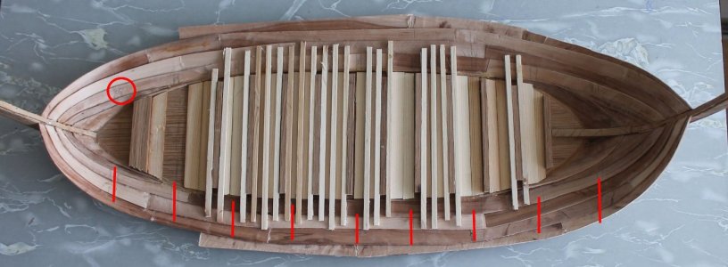

I copied the lines from the drawing onto a piece of paper that I stuck to the frame. The model lies on top of this, allowing me to apply the lines to the model.

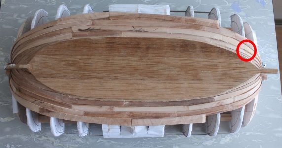

At the stern, you can see three nail heads in the circle. I thought I would apply a series of nails here and there so that I wouldn't have to add a bulk afterwards. That turned out not to be such a good idea, because it meant I had nailed the model to the frame. I was able to pull out three nails, but if there had been a few hundred, it would have been more difficult. So I'll just postpone this until I no longer need the frame.
Now for the current state of affairs.

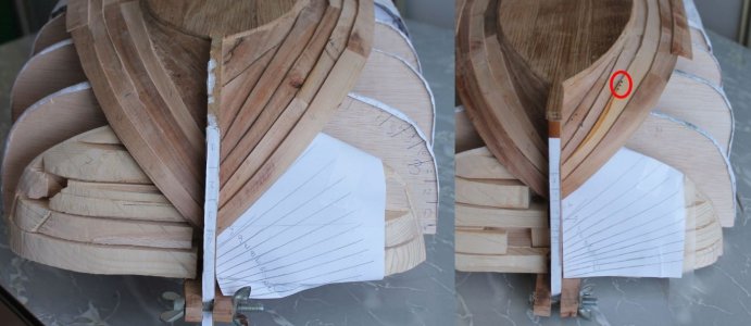

The bow seen from the inside. The coming strakes will be very narrow at the stern and much wider towards the middle, creating a fan pattern.
The model seen from below. The three nails are visible in the circle.
The model seen from the inside. Some more wooden pieces have already been added here. Not everything yet, because the frame must be able to stand on the bottom at the location of the red lines. In the circle again, the three nails and exactly on a red line where the frame is located.

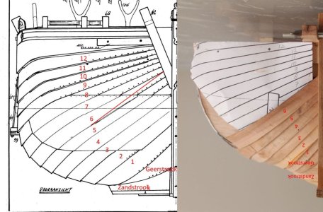

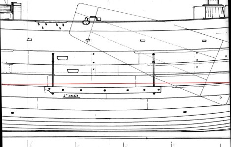

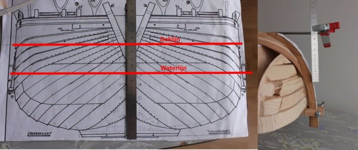

The front view looks like this:
Left according to the drawing and right my model.
In the left drawing, I have marked the course of my sixth strake in red. I am too high at the stem and going down too steeply. I think I can still compensate for that by making the planks slightly narrower at the stem and slightly wider at the stern. I still have 6 strakes to compensate for that.

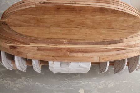

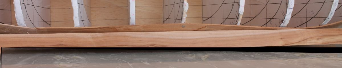

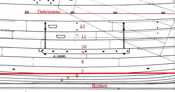

Something else, the sheer.
My model has a slight sheer on the bottom. Compare it with the straight slat that is lying on top of it.
In the drawing, there is also a slight sheer when viewed from the side.
The sheer can be seen below the red line. The sheer is concave here (lower in the middle than
on the sides). My model is upside down, but if you put it upright, the sheer is convex there (higher in the middle than on the sides).
In the next strakes I will have to work from convex to concave.

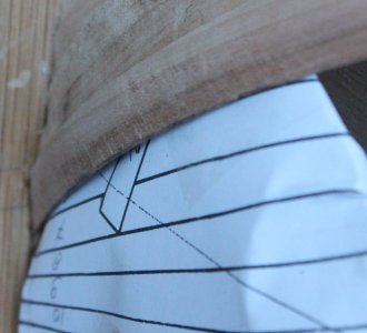

Then another mistake.

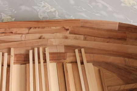

07-4-spleet.jpg4
This is the start of strake 6 at the bow. Here you can clearly see that it does not fit properly against
the mold. forgot to bevel the previous step here.

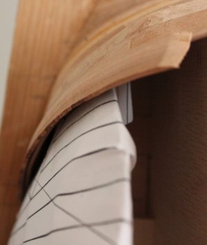

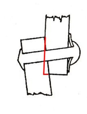

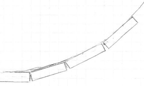

In Petrejus' book (De Bomschuit, een vergeten scheepstype) there is a sketch showing how a rivet is attached, and the
beveling is clearly visible.
07-5-lasmetklink.jpg5

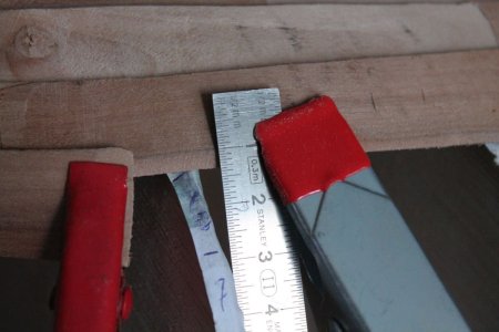

The right plank is slightly beveled lengthwise so that the left plank meets it at an angle. A rivet must then be driven into the overlap. In reality, this is done at a distance of 5 cm. On my model, this is 2.5 mm.
I did the beveling over a distance of 3.5 mm (slightly more than allowed).
Beveled from 10 to 13.5 mm on the ruler. Later, some nails will have to be applied to that edge.
I reapplied the start of strake 6 after chamfering strake 5 a little.
With this result:
That looks a lot more acceptable.

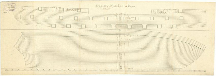

I would like to see a planking expansion drawing of a bomschuit. Do they exist? I think the planks of the bow and stern would spread at the and as the 5 fingers of a hand.

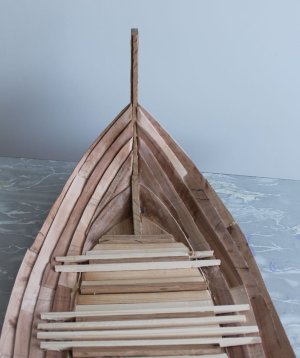

Update 8

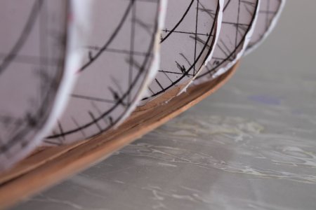

I'm making a bit of a mistake.
As you can see in this photo, the last plank no longer touches the bulkheads. And that's not because the bulkheads aren't aligned, because they are.
So what is the reason?
Now I remember experiencing something similar when planking the Kamper cogs, but to a lesser extent. I couldn't figure out the cause at the time, but now I think I know.

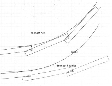

In update 7, I showed that when the planks overlap, one of them has to be bevelled. This means that the planks are not exactly parallel, but at a slight angle.
It turns out that it cannot just be any angle, but an angle that allows the new plank to follow the curve of the frame.
In my case, the angle was apparently too slight, causing the plank to run away from the frame.
My club mates at the bomschuitenclub have already built several bomschuiten and never had this problem. How is that possible?
Well, they always built the boat with bulkheads. This means that the planks were not attached to each other but to the bulkheads. If you don't bevel them enough, you end up with a gap. Well, you can fill that gap with something.
Why don't you have this problem when you build smooth-sided boats?
Well, you always build against the bulkheads and you have to bevel the sides of a batten slightly to avoid gaps.
Now for the solution for my problem.
I see two options.
1. Loosen a number of planks, chamfer them correctly, and glue them back in place.
2. Temporarily secure them to the bulkheads with a nail and continue. The next plank should then hold everything in place.
Option 1 is the best if it works, but option 2 is the fastest.
I want to go for option 1, but first I will try option 2 to see if that works.
In the middle, the skin is attached to the bulkheads with a nail. But it is clear to see that the plank curves upwards there. By pressing that plank (which in the old situation had a nice smooth curve) upwards with a nail, it now forms a bubble, whereas it should actually have a slight camber, as can be clearly seen in the drawing below. The thick red line above the sixth line is straight. Plank 6 protrudes above it at the ends.
Plank no. 6 shows a slight camber here, but the model shows a bulge.
Option 2 does not work, so it will be option 1.
To be continued.
Translated with DeepL.com (free version)
