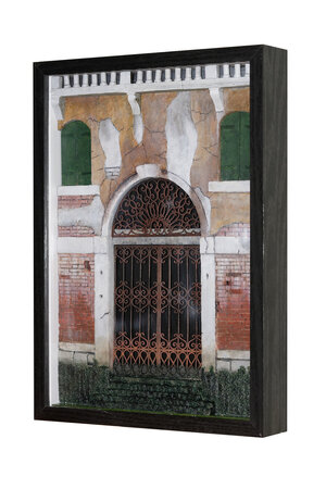

A piece of Venice (framed)

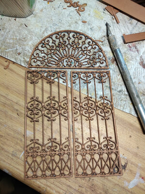

How did you cut out the gate? More process info on all the wonderful textures and construction, please. It may not be a ship, but I am sure we all have a lot to learn from your processes that will convey to our own purposes.
Pete

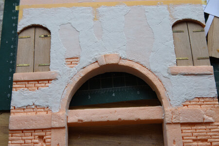

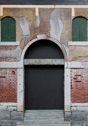

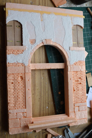

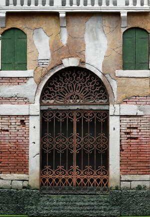

I made this diorama as a gift for one of my friends (he is Italian and comes right from the Veneto region, but lives here in Moscow) to make him a little homesick :)
The materials used are quite simple and cheap. The base is from PP-foam sheet, cut with Proxxon thermo cutter. The plastering effect is obtained with acrylic putty. The iron gate is made from laser-cut veneer. The fouling plants are from colored sawdust. Everything is painted with water-based acrylic paints.
