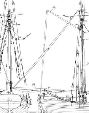

My plan circa 1985

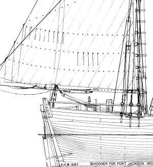

KH Marquardt circa 1987
Attached also is the rigging list.
Kind regards
Allan Tyler

Thanks for your reply. I have your drawing - which does show the tackle could be on the port or starboard. It must have been a bit of drama swapping it from side to side at times! I like the little detail of the khm drawing with the hooks.
The tackle was really a preventer rather than a vang as we know it now. I'm guessing they might only have used it when running or in a big sea.
Great drawing by the way.
