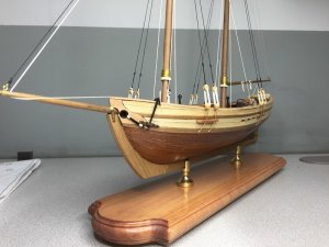

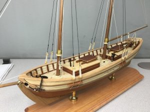

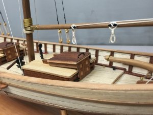

Hi Bob. I finished the Swift using Bob Hunt's practicum a couple years ago. Not sure which version of the AL kit it was but I recall it being a very basic build. Mine had the removable deck houses and the step down aft area. It was a nice kit and fun to build. Here are a couple pictures of mine.
Mike
