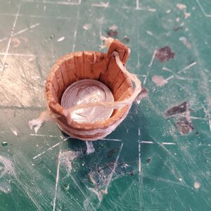

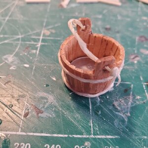

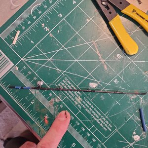

Mashed my finger with a hammer. "Lure" is a few shavings from some orange 550 cord and some ca. Best idea I could come up with at the scale.Cute bucket for sure.!!
Not sure what is on the fingernail.?? Looks like two little blood blisters.!! Is that supposed to be a fishing lure..???
This bucket is looking very good - is bringing some life into your boat model - only some fishes are missingWhile not technically sjip related, thought I'd shre the fishing pole and bucket . Poor little boat was looking kinda bare.

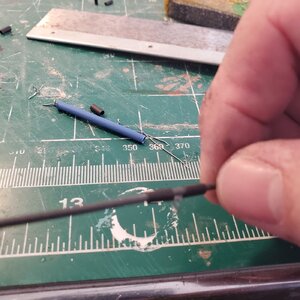

I chucked a 2mm carbon rod in my drill, tapered to a point. The eyes are solder twisted around different size drills, legs shrink tubed down. The reel was painted balsa with a wire standoff, and the crank was a piece of solder with the ends melted to balls to make the handles and sharpied. Id like to see that tackle box of yours, might make one too. Btw, carving some fish to drop in the bucket with some acrylic water. This diversion is fun while scratching my head over my recent botched efforts at a real ship.Nice add-on's. Those kinda things make a model much more realistic. I like the rope rub rail. Well done.
