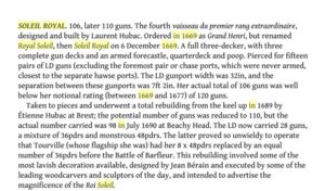

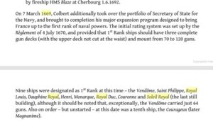

Rif Winfield says (French Warships in the Age of Sail, 1626–1786)
So 164 ft 6 inches would be right for the gun deck and 142 ft for the keel.
