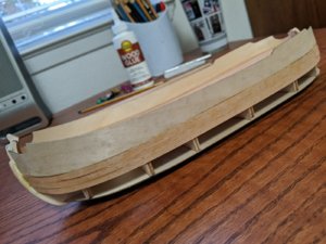

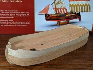

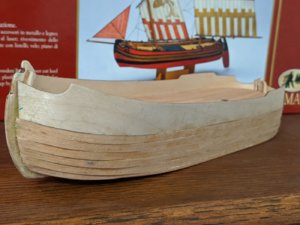

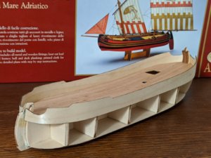

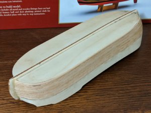

To start with I've attached photos of the current view of the little boat, which has a ~31cm hull length and would roughly come to about 1/75 scale. I have all of the planking done on one side. I attached the top most planks with the railing slightly higher than they should have been so I needed an extra plank to take a sliver out of along the bottom edge. Thankfully I believe there is extra material from the decking, one of which I used to get this done and another of which I'll need for the other side!

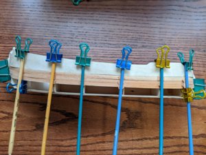

The crude method I used to fit and dry the planks onto the frame was to stick paint brushes into the paper clamps, and then use bits of a cut up plank and some other things as spacers to hold the planks in place... It got messy at times, but it worked.
The construction method for the kit involves a single layer of planking, but I'm not worried about the gaps I've got since the hull will be painted, as on most of the surviving trabaccolos!
So here's where things stand now... I won't use any filler until the wood on the other side is done to make sure things remain rather even, and also to see if I can do any better on the next go! This will probably sit as it is until I return from a business trip in early February. Until then, cheers, and happy holidays!
