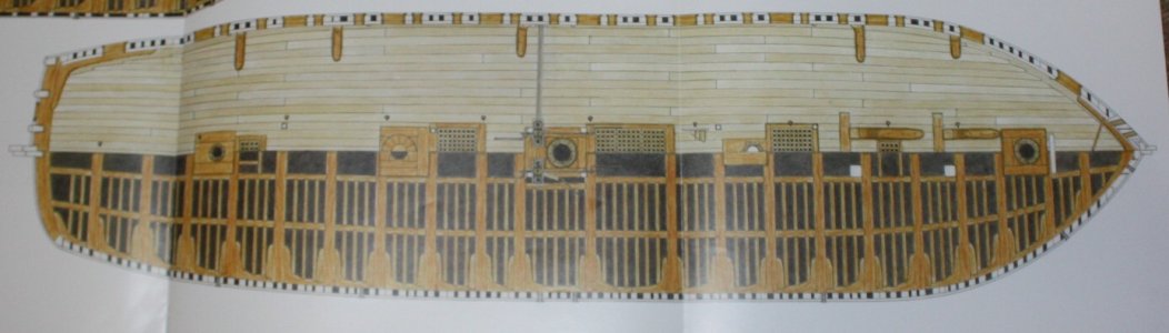

I too have been researching the decks of early 4th and 5th rate ships and I think enough research can be put together to come up with a reasonably historic layout for the deck.
I am putting together the next part of the build log on installing the wales and upper planking.
