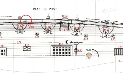

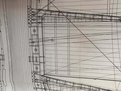

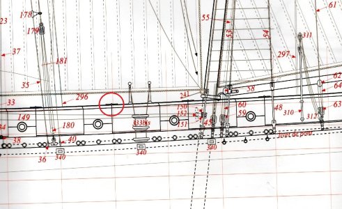

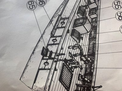

see the plan I posted previously

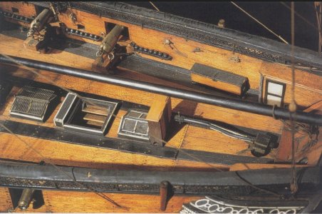

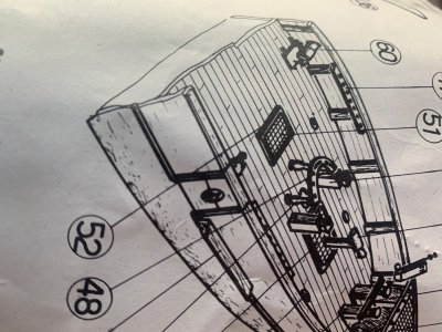

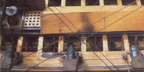

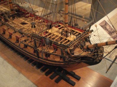

I wouldn't trust a plan with so many simple and stupid errors. Personally, I would throw it away as soon as I saw the grated hatch covers on the deck. This plan was drawn by amateurs.

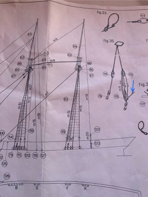

round the hook at the bottom of the lower block.

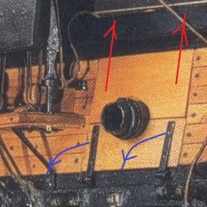

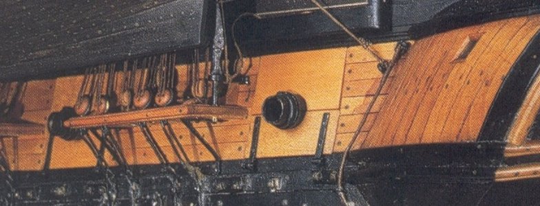

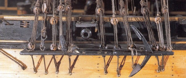

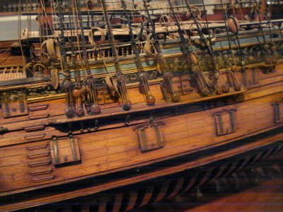

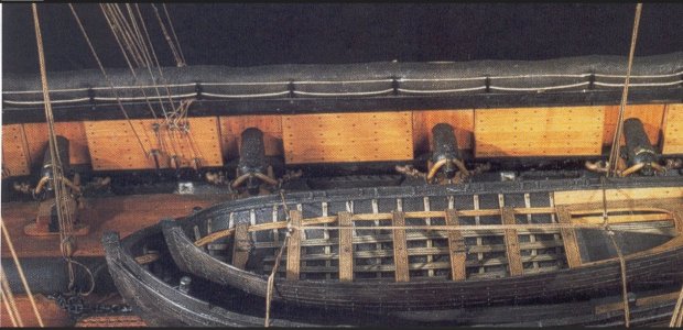

there are definitely no hinges to the bottom part
In such cases, both halves were removed upwards along the guides. I know of at least two French ships with such covers, without hinges.

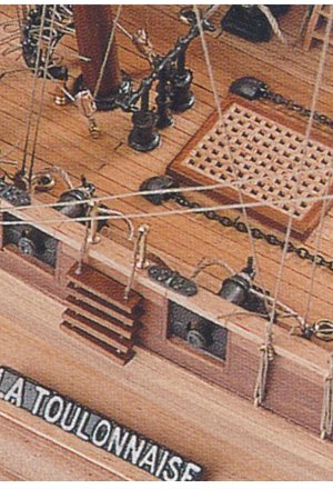

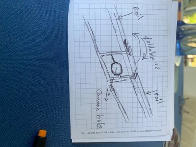

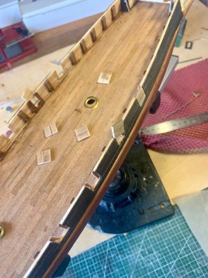

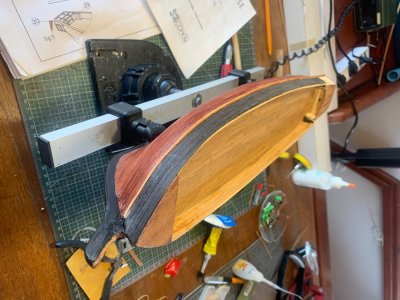

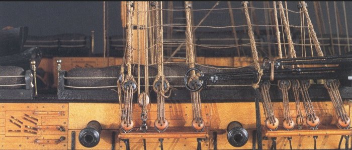

Now i have prepared the sliding ports for the carronades under the foldable rail parts. I plan to cut each port into 2 parts horizontaly the lower piece will be attached with hinges to the hull or wale.Thrse 2 parts can also be simply glued to their frames,but i want them to be functional.
It will take more time to make them functional but worth for the own satisfaction.That is why we are building this models For Challenge and Pleasure
(Unless you buuld them for selling and making some profit)
Beautiful!
As for the gun ports: do what you like (they are un two parts for sure). The most important thing is that you enjoy yourself.

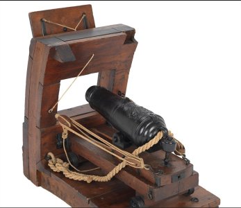

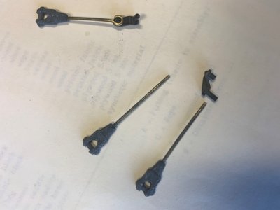

I replaced the plastic stuff from the Corel-kit for attaching the guns to their carriages using 2 mm pipe- and 0.8 mm thicknes brass wire for better stability
I hate material made of plastic
CheersBottle
I have to admit that these plastic parts are not very attractive.

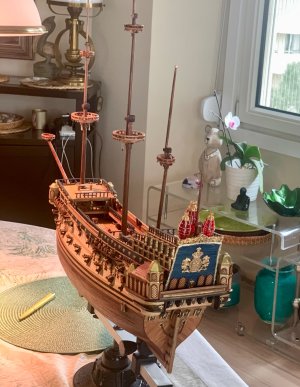

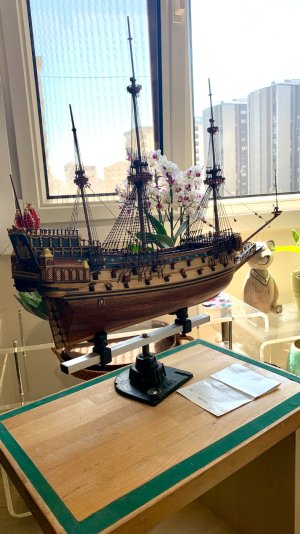

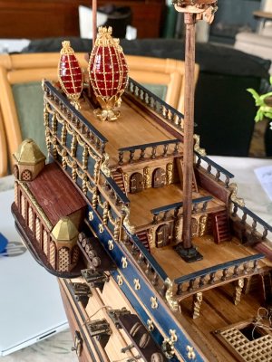

Here are some photos. Nearly finished... 46 years after ! With some mistakes and personal touches...
Nicely done .I am sure that your photos will help me by my La Toulonaise modeling. By the way i bought this kit with other 3 corel models together in 1982 by a shop on istanbul which gave up busines.The kit is 43 years old amd i opened and started with it 2 months ago.nearly same age like your ship.İn the meantime i allready finished the other 3 models.
