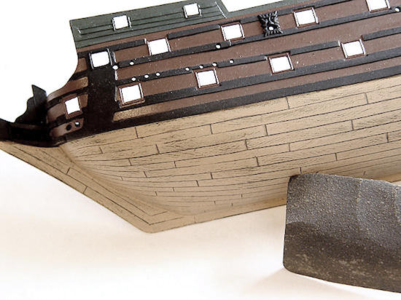

A long time ago, I put together the Lindberg Captain Kidd (many years ago). Which of course is a plastic kit. What I did is that I painted the entire hull flat black (if I remember--see the link) and also the deck. The plastic deck and hull had simulated "Raised texture" of the wood. I then painted a coat of light brown and tan. Then I took a very fine sand paper like 1000 grit and lightly sanded away the tan and brown which exposed the darker (black) which started to reveal the texture of the plastic grain. Then I had what I thought was a nice grain affect.
here is the log that I show how I did this.
Thanks for taking the time to reply Donald. Appreciate the build log link. :)
