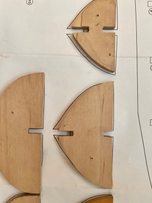

IMG_0112.jpegFirst question: It appears that the bulkhead cut outs in this kit (LeClerc. Not lazer cut.) Are wildly inaccurate based on the drawings. Unfortunately, in some cases, too small. Should I get some ply and cut my own by hand?
Maybe first take some measurements from the parts and compare them to the other drawings to make sure it is the part that is inaccurate and not the drawing.

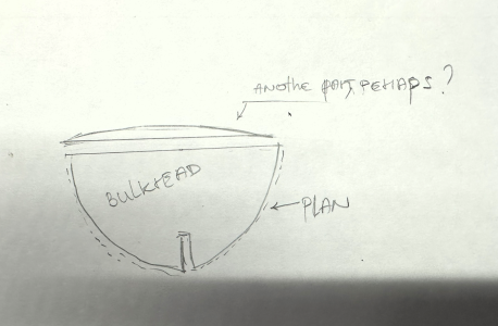

Also, from what you are showing, it looks like they did not shape the top of the bulkhead to get the curvature of the deck for drainage.
Assuming the parts are the inaccurate component here, your thoughts probably have some merit. :)
I agree with Jeff. Because of a deck curvature, the bulkheads should have a curvature shape. I assume there mybe other parts going on top of each bulkhead with curvature. I would compare the bulkheads with plans using the keel notch instead of the top. Align each bulkhead using the keel notch.
Thanks! None of the bulkhead blanks have enough overlap to allow sanding to shape the deck curvature or the full hull shapes. I trust the plans. I think I will try a test on Jimsky's idea of adding a scantling atop the bulkhead. I will keep you posted. Thanks!

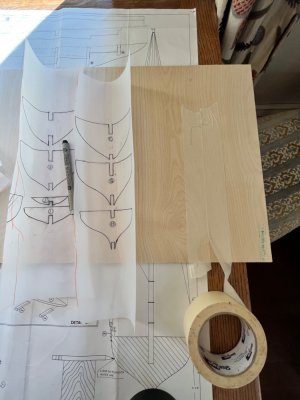

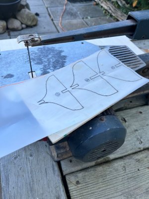

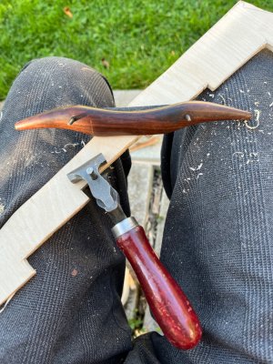

Well, a kindly neighbour loaned me a mini table saw and a fret saw. He also sold me some beautiful 3/4 in. Baltic ply (He owns the lumber yard in town). I am cutting new bulkheads according to the plans. I am also cutting a new keel and deck. With these tools, I am cutting strips of teak and ash and pretty much anything I see tucked away in the garage!
