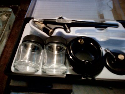

Hi, I have just purchased a cheap air brush from ebay $17.00 it looks as though it will do what I require ( I already have a compressor and regulator ) I will let you all see after I have sprayed my first model. Here is a picture of the kit I purchased.
