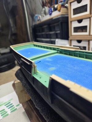

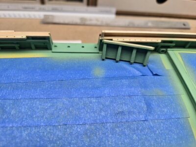

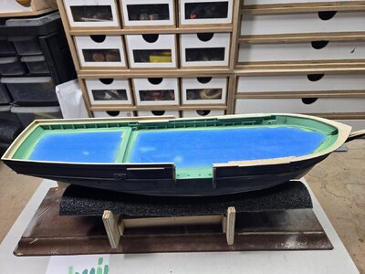

Here's an example of airbrushing bulwarks, tougher to do using and artist brush. I use a shellack sealer, no primer. Airbrush of choice is a Badger 150- and 3-gal 1/3hp, 110psi pancake compressor (Harbor freight). A little loud on startup but airflow is more consistent than the tankless hobby compressors. If compressor noise is an issue, the small hobby type works well on small projects.

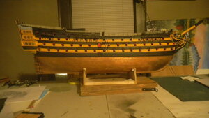

Just my opinion as an old sign painter & airbrush artist. I don't see the time & effort in using an airbrush for ship models worth it, especially if you're not experienced with it's use. You need a proper mix of paint & thinner, control the flow properly, mask all around, prevent overspray from surrounding areas, take the brush and cup apart to thoroughly clean them. Much faster & easier for me to just use the paint brush. (Exceptions are when you need a smooth gloss finish, such as model cars.) Examples of when it's worth it and really not for me (Victory).
