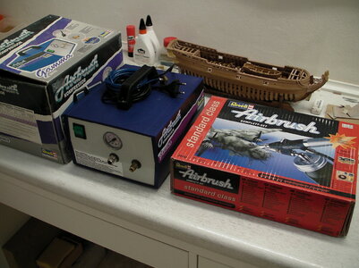

In some cases, an airbrush replaces a paintbrush in model making. Neverless, the brush is irreplaceable for painting decorations and figures. Buying an airbrush is like buying a lathe, a mill or a circular saw. You have to familiarize yourself with it and learn a new technik. Cleaning clogged nozzles, diluting colors, etc. must be learned. Also, good substrate preparation and masking of the part will ensure the incomparably painting result.

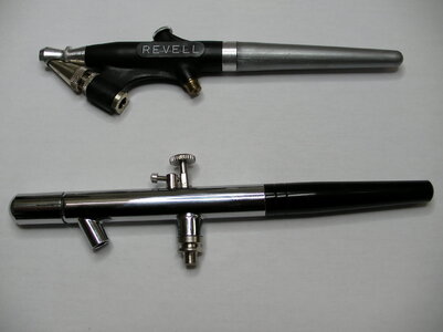

Above: a single action airbrush. The amount of paint is controlled at the bottem left by opening or closing the nozzle. On top of the airbrush is a push button that releases the airflow through the airbrush. Easy to use and clean.
Below: a double action airbrush. Paint and compressed air are controlled with combined push button for the air and simultaneous pull back for the amount of paint. Requires more practise.
Single action airbrush.
Double action airbrush from another manufactorer.

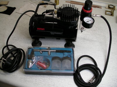

To the airbrush comes still the acquisition of a compressor.

An airbrush is always a precision device, no matter how expensive. Also the compressores are available from simple to best equipped. You have to know how often you use them and what benefits you expect. The paints today are water based and work in all airbrushes. For solvent-based paints, the double action airbrush needs suitable seals, good ventilation of the work area and a breathing mask. There is much to consider.
The expensive airbrushes and compressors for graphic artists and other professionals are not always necessary for our work. Of course, the seller will usually advice the buyer to choose the "best"? Banknote-USD
My first experience was spraying water on newsprint. Then black paint in several thin layers on paper. Each pass was dry in a few seconds. I was thrilled. The first time I cleaned it I had a lot of dirty clothes with detergent, dirty hands and I dropped the paint pot. As a result, the airbrush disappeared into the closet for a year. :mad: Today I can laugh about it heartily. With proper use, the cleaning of the airbrush is not dirtier than a brush cleaning. Beer

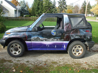

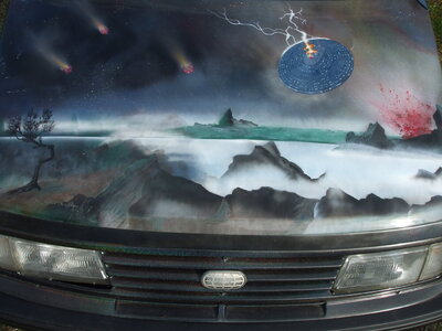

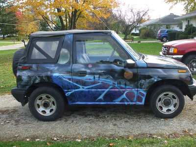

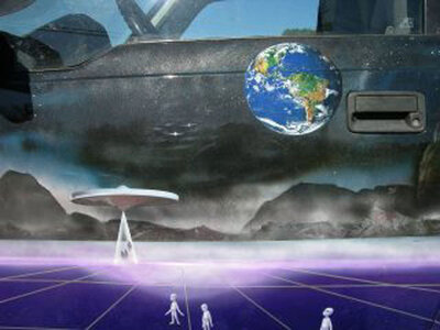

i have been using an airbrush for many years and i have 6 of them. Everyone is double action
it depends on what you are going to do with it like just paint a flat color on a model or do art work.
i use both water base and automotive paint.
like any other tool there is the hobby grade and the pro grade the best one i have is a Wold it belonged to my dad who was a professional photographer and air brush artist. But on the other hand my kid brother does remarkable work with a rattle can (spray paint in a can)
the one i use the most is the Wold and it is over 50 years old, i think, so getting a good one on ebay may be the best deal rather than buying some hobby grade one.

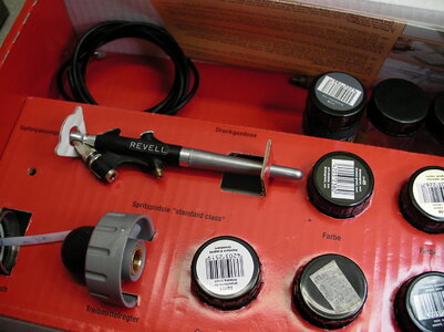

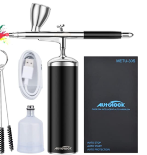

This is the first I've seen this. I'd have reservations about using this due to the weight and bulk of the compressor attached to the brush. Imagine using a regular brush with this bulk attached while painting or writing with a pen with this attached. I guess it would be ok for painting applications like you would do with a rattle can.
I have to agree with you. I use one of those fold up 12”x16” spray booths. I think having that compressor attachment on the bottom would really limit the ability to spray within the booth at different distances. Plus I would think it would really impair fine brush control. Maybe it’s meant for large spray booths and larger items?
I also don't believe you can regulate the pressure. I don't know if that is something that is adjusted a lot, but I would imagine for delicate PE parts, you wouldn't want a high pressure spray, so maybe this thing isn't worth the money. Anyways, thanks for the feedback
