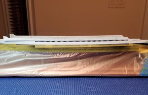

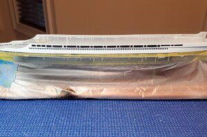

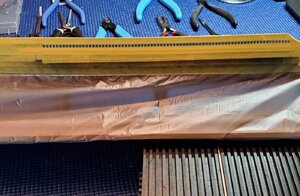

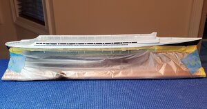

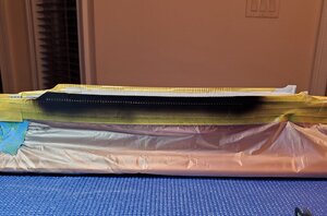

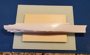

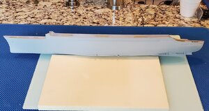

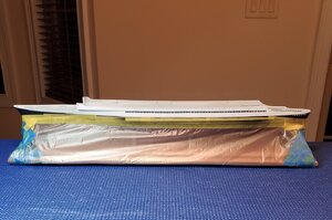

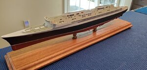

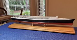

After enjoying building the Airfix 1/600 RMS Queen Elizabeth I purchased as many 1/600 Liners as I could find. The rarest one is the Airfix SS France which I finally found on ebay at a high but reasonable price. She is my current project but I have to be careful since messing her up and trying to replace her would not be easy.

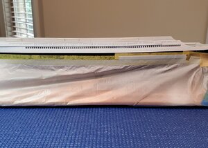

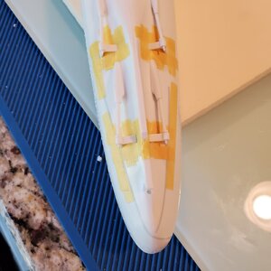

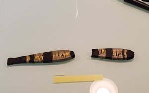

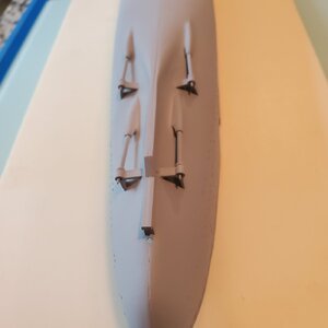

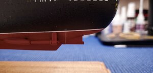

So far she is in prime with the propeller shafts and stabilizers installed. I really would have preferred to leave them until near the end of the build but they needed a lot of filler which would have messed up the paint job. I'll just have to watch out for them as they are very delicate. Once I get the hull painted and mounted on the stand they will be much less vulnerable to damage.
The holes for the shaft supports were just a mess and the hull had quite a bit of warp to it so I filled the support holes first from the inside with styreen sheet and then putty on the outside. I also glued in a brace of styrene sheet to help hold the two halves of the warped hull together. She needs a little more filler before paint.

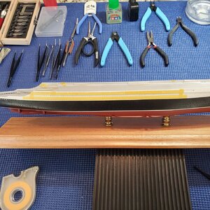

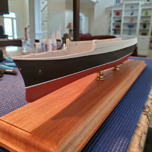

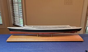

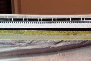

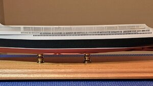

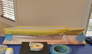

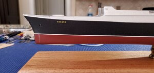

I've been dealing with my Mom's health issues so I haven't had time to work on my 1/600 France. Today I took a little break and did some painting. Not so sure about the color I chose but the ship had green decks. This color is a gray that has a green tint. I really don't want to paint it a dark green so this is what's going to be on there. 25 Paint.jpg

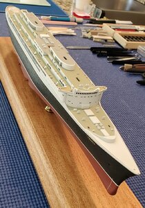

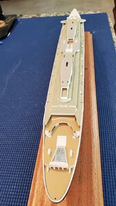

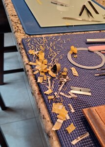

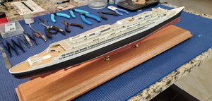

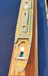

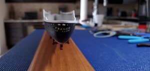

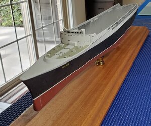

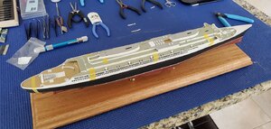

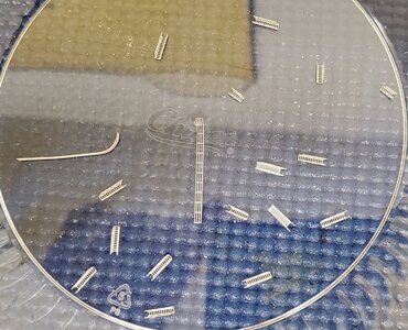

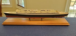

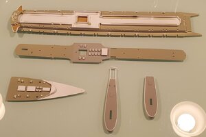

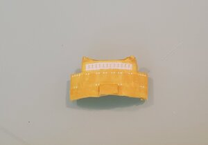

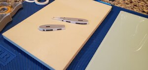

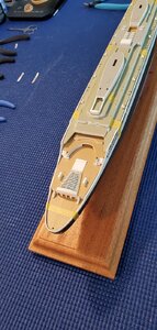

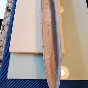

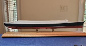

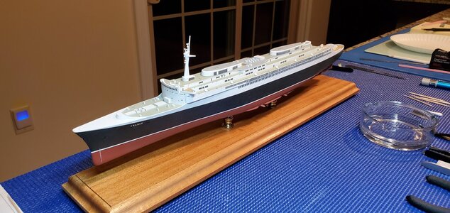

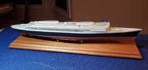

I permanently glued down the decks and bridge36.jpg36A.jpg37.jpg38.jpg39.jpg. I also added window decals and some photo etch doors. It took some filing but it went together pretty good for such an old and warped model. I think I'm going to add some styrene posts on one of the stern decks as it looks a little empty. It also still needs some seams closed up. Then on to the railings and other details.
