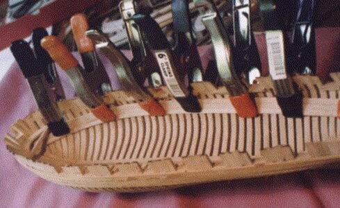

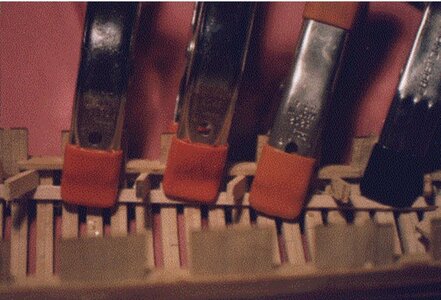

these hulls and timbers take on strong clamping to bend, woods like basswood and alaskan cedar are to soft to take the clamping pressure, the wood crushes. That is why woods in the harder range are better. Beech, maples, cherry boxwood pearwood they can take on strong clamping and hardly leave a mark.
softer woods are fine for delicate work and trim.
