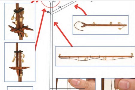

This is probably a stupid question, but….I’ve started work on the masts. How are you attaching the yards? The instructions show where the yards attach to the masts, but they omitted how to attach them.

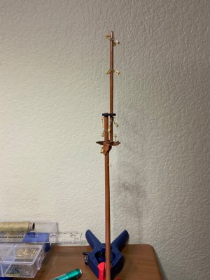

Today I completed building the foremast and tomorrow I’ll get the yards done. I still have no idea how to attach the yards to the mast. I guess that’s a tomorrow problem, but any advice or pictures would be much appreciated. I looked online and found some great line drawings on how they were actually attached, but none of them were applicable to my build.
I switched to Elmer’s glue on the blocks and that seems to work much better than the CA I was using. Thanks for the advice on that.

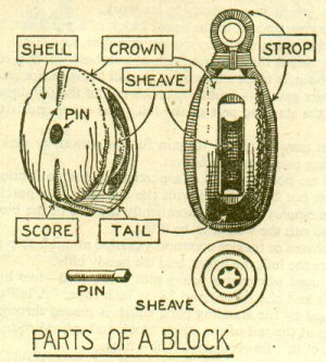

Sorry to point this out but all the blocks are upside down. Easy fix by drilling a hole in the proper place without taking them all off and retying. As they are now, the line would run over the tail instead of the would be sheave and under the crown. I drew the holes in red to show what I mean. Hope this helps
View attachment 523525View attachment 523526
Great info. Thanks for the quick lesson. That makes perfect sense and I’ll install them that way from now on. I think Occre set me up.
The question of how the yards were attached is based on class of ship, country of origin and period modeled.
Most had a single or often double block setup to hoist the yard into position, but after that they often were held in place by a combination of ropes around the yard going up and over and around fittings on the mast. Many mast caps had supports for the yard to help bear the weight, and the block and ropes used to raise the yard would not hold up to daily stress.
Look at the rigging plans for ropes that go from below front of mast up thru the cross trees and then around the back of the mast.
Most yards had a loop where it starts at backside top, goes forward, under and up thru loop and then up to the crosstree for supporting the yard.
There are many good books on rigging period ships available.
