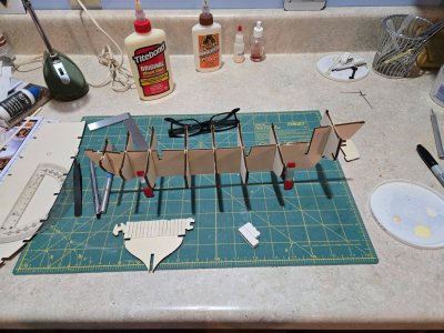

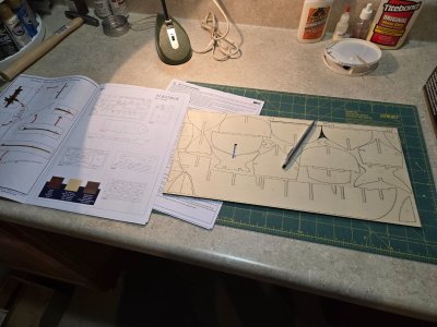

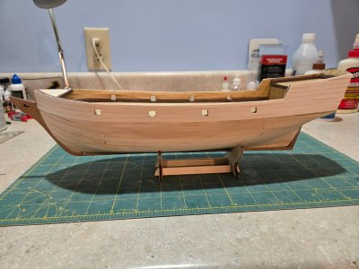

Yesterday I started my first real ship build if a schooner is considered a ship. (I read that if a schooner was in the British Royal Navy, it would not have been considered a ship). Previously I have completed the Lowell Grand Banks Dory, the Norwegian Sailing Pram, and the Muscongus Bay Lobster Smack. The first two by Model Shipways and the latter by Midwest. I'm hoping I am now capable of doing a decent job on the Albatros. Here are some pictures of my start.20250520_100036.jpg20250520_100020.jpg

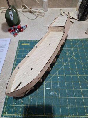

I have cut out the keel and all of the frames and dry fit everything including installing the deck. For frame 9 I decided to plank it before installing it on the keel. All of the frames have now been glued, and the deck still fits.
Looks like a good start to the build, and I see some Lego used to square the bulkheads I assume.
As for if its a ship, the old Navy saying goes, if it floats, and is not carried onboard a larger ship, its a ship, small craft carried on board are boats, except for submarines which are always a boat!

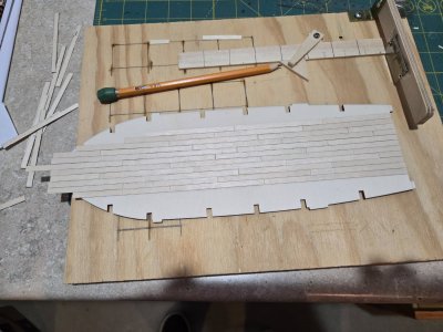

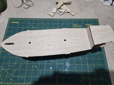

I have started to install planks on the deck. I am using an 8-6-2-4 pattern with the full planks being 8cm. For the caulking I am using a pencil on the edges before I glue them down using white glue. I had planned to use a Sharpie on the plank edges but read where there may be issues of bleeding or smearing when varnishing. That leads to my first question. I purchased the Occre paint set for this kit when I got it. None of the build logs or videos for this kit really address the painting/staining aspects of building this or other kits. The paint set included varnish as well as a couple of stains. One post mentioned tinting the varnish. What is the proper method of finishing the deck using this paint and stain set?
In case you wonder, that is my OldeManToad industries chopping tool I made several years ago for building railroad trestles.

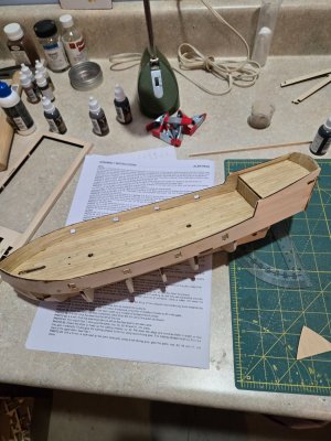

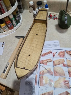

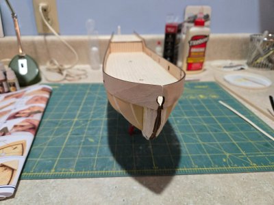

Completed the decks and attached them to hull.

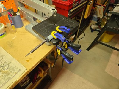

Here is my soldering iron set up to try some trial bending of a plank. If that is successful, I will use it to bend the bulwarks.

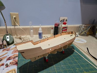

Installed the reinforcing chocks and started sanding them and fairing the hull. Im satisfied with the bow but the stern probably needs a little more sanding.

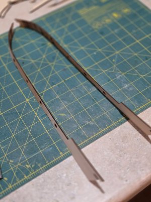

Here are my two curved bulwarks. The soldering iron made it pretty easy to do, but I think my iron was a little too hot. Even though I soaked them well before bending them and frequently, they were scorched almost immediately. Not a problem because these will be lined with planking. This method of bending I got from John Aliprantas's videos. I highly recommend watching his videos. Waiting for Instant CA to be delivered by Amazon today and will start attaching them tonight or tomorrow.

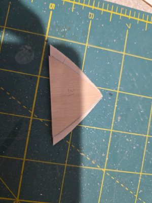

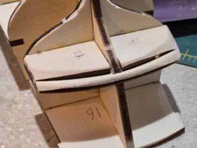

I cut out the bow deck piece and went to dry fit it. Wow, that piece was way to narrow side to side to fit in the bow. I had to make a replacement part out of some scrap wood left from previous boat. Below you see my piece under the original piece. I have not seen any other build logs mention this. I thought maybe I messed up installing the bulwarks at too much of an angle, but even laying the original piece on the deck it would not fit side to side. This is one of the joys of model ship building.
That looks great. The Albatros is my first ever build as well and I’m learning a lot. One of the many things I’ve learned to is dry fit the masts before the deck is glued down. I didn’t do this only to find the masts didn’t fit into the intended slots. On my second planking not all of the strakes laid flat. I think it’s because I sanded horizontally but didn’t sand vertically at all. I also found the wood used for the second planking is very brittle and chips when trying to cut it - even with fresh blades. I’ve always wanted to build a museum quality one hundred gun ship of the line and purchased this one to start learning the skills I’ll need.

Here is a pic showing the waterways and other trim pieces installed. I considered using the 2x3 African walnut strips instead of the 2x4 strips for the waterways but decided to follow directions.

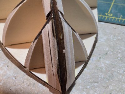

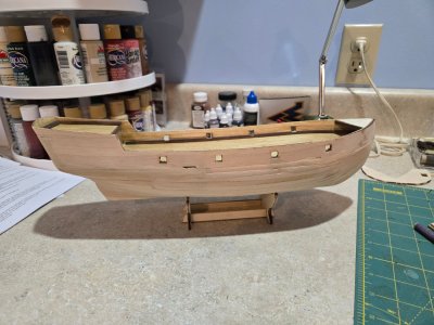

Here are some pics showing the sanding of the first planking just started. I have a lot of sanding left to do. If you look at the canon ports you can see that I have started to grind out the ports. I used a small Dremel bit to do this but I have yet to finish filing them down.

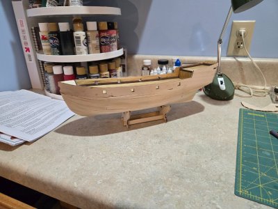

Been awhile since I last posted. I made an executive decision to install the keel parts before starting the second planking. Took a lot of sanding to get these to fit just right plus had to cut a hole and refill it to fit the stern piece in. I'm very pleased with how that turned out. This would have been very hard had I done the second planking first. I also decided to use contact cement instead of white glue like I had planned. This decision was made after watching other's videos having to use tape and other methods to hold the planks in place while the glue dried. Got the bulwarks planked and I'm ready to move on to laying some sapelli planks. Before that I am going to paint the keel parts but haven't decided between dark brown paint or walnut stain. Any suggestions?
I used the walnut stain and was very pleased with how it turned out. I used the scrap wood the parts were removed from to try out the different stains first. I used contact glue for the second planking as well.
